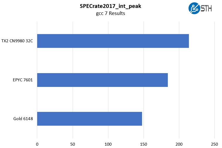

SPECrate2017_int_peak

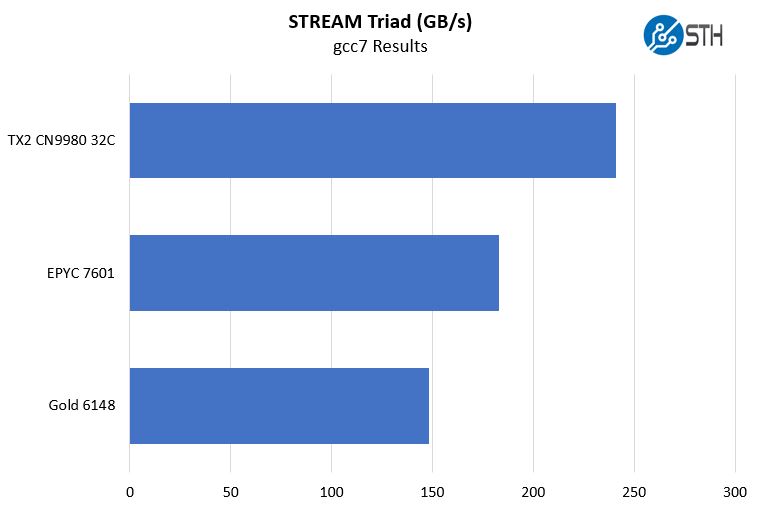

STREAM Triad Memory Bandwidth

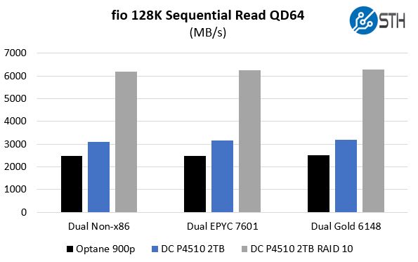

Storage Performance

Better performance than I expected if I'm being honest. Integer performance looks very good, but that power consumption. . . ouch. Even taking into account the early silicon and unrefined firmware, I think that's a hard sell to get worse or equal performance with less IO and significantly more power draw. We'll see what they can do in the refinement stages.
