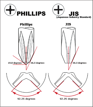

I noticed sometimes from China and Taiwan use JIS and not Philips standard.
If you stripped your screws then you will need to use an extractor.
Those screws look like standard "rightie-tightie, lefty loosy" phillips head (or maybe JIS) screws...
I was thinking the exact same thing.. its probably a JIS standard.
P2 drivers tend to not work very well on JIS.
I use a Vessel Ball with JIS and PH2 incase i run into situations where PH2 doesn't quite fit right.
Incase people dont know JIS is a bit different from PH2...
Here is a picture i found...

Its probably because your using a PH2 driver and and the screw is JIS.

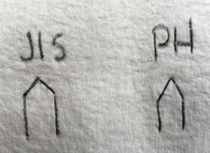

Going by the manual, which are diagrams rather than photos, they actually do look like JIS B1012 (without any identifying dot or X) in fact they can't be anything else as the sides of the central area are rounded.
In original Philips and PH/PZ ISO 8764, the latter of which is supposed to have replaced JIS in Japan, both have a diamond shaped central area.
JIS B1012 needs a much flatter tip to the screw driver otherwise it won't engage the cross slots fully and will slip. I've had exactly that trouble myself with a non-PC related screw head problem.

I've had luck using a file to knock off the tip on a Philips to shape it "good enough" to work on JIS. It's not what I'd do for regular use but to get a few screws out I'd try that. YMMV.
For that matter you could just file or grind down a flat bladed screwdriver to engage on only half the head's slot area, just have to be that much more careful to keep it aligned when turning. It should be a decent quality bladed screwdriver, not something made of buttermetal that can't stand the torque.
This is why I keep redundant pieces, old screwdrivers/wrenches/etc around, with no reservations about modifying them to suit certain needs, especially old unplated wrenches that I heat with a torch then bend into the shape needed to get into a tight area.
