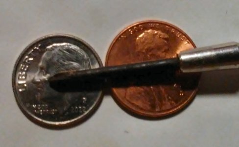

Again... this is the one that's too small. It was adequate for my laptop screws though.
Can you tell by this picture what size it is?

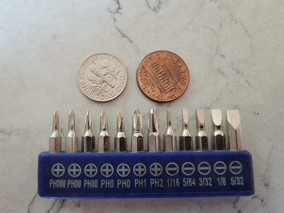

I am guessing that the JIS driver aigomorla is recommending is the size equivalent of a PH2 because of the two's in its model number, 220 +2x100. But that's just a guess!
I'm pretty sure that phillips #2 and JIS #2 are very close to the same size...just cut differently.

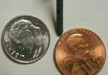

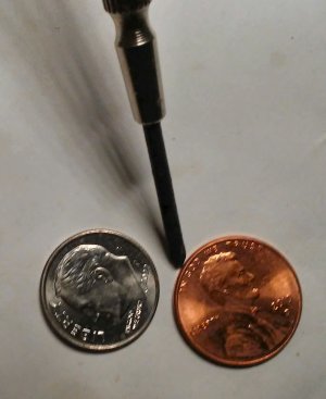

Based on shank diameter (# pixels), shank not machined down to s smaller tip diameter, relative to known coin diameters, what you have pictured is either a 00 or 000 size.
I estimate it's about 2.5mm #00 while a size 0 is 3mm diameter, size 1, 4mm, size 2, 5-6mm.
That is also consistent with BoomerD's picture of coins vs phillips bit tips, except the tips in that pic are rotated slightly to appear slightly narrower in the pic than their true tip diameter.
Scaled 1 grid line per mm:

Based on shank diameter (# pixels), shank not machined down to s smaller tip diameter, relative to known coin diameters, that is either a 00 or 000 size.
I estimate it's about 2.5mm #00 while a size 0 is 3mm diameter, size 1, 4-5mm, size 2, 5-6mm.
Well then. Unless JIS screwdriver sizes are way different and smaller than Phillips sizes, I have the wrong tool on the way from Amazon. I ordered the one that aigomorla recommended in posts #9, 27, 29, 34, 38 and 56. Because the PH I photographed is a little too small for the screws that are stuck.

If the tip is machined well, you can often get away with using a size larger or smaller than the ideal, but the smaller the screw, the more it matters. Also I added a scaled pic to my last post that you probably didn't see based on time of last post.

To my eye, the screws holding my laptop case together look identical to the screws on the ASRock box I need to remove. And the tool I photographed is what I used on the laptop screws over the years, but it was too small for the ASRock screws.

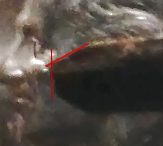

It could be that the screw head slot is slightly larger, or it could also/instead be that you have worn away the tip on the pictured screwdriver a bit, as your first pic did show some wear like it might have fit the laptop screws better if it had the pointed end of the tip filed off so it had deeper purchase on the screw.
If it is a #00, what I would do is use a file, with it in a vice to get more precision, and true up the tip and then consider it a #0... and it might work, or might not, for the miniPC. I mean file each lobe at 90' to the face of the lobe, until the deepest worn lobe is no longer concave but flat like it started out, and then file the other 3 lobes to the same depth, then file the end of the tip flatter.
Below is a zoom in on your first pic showing area on one lobe to true up and take some off the tip. If you don't have a good sized, fine toothed file (or completely flat sanding block) and a vice, or patience and great attention to detail and a knife sharpening stone, it probably won't turn out precise enough.
It may not be worth the bother, but the more worn the tip gets, the more risk of screw head damage and further tip wear trying to use it on *anything* in the future. I'm not necessarily even suggesting that filing the screwdriver you have will be enough. If it still doesn't seem to fit well, not worth the risk to try too hard with it instead of getting a new screwdriver to try first, especially one with a proper handle so you can get more grip and leverage.
