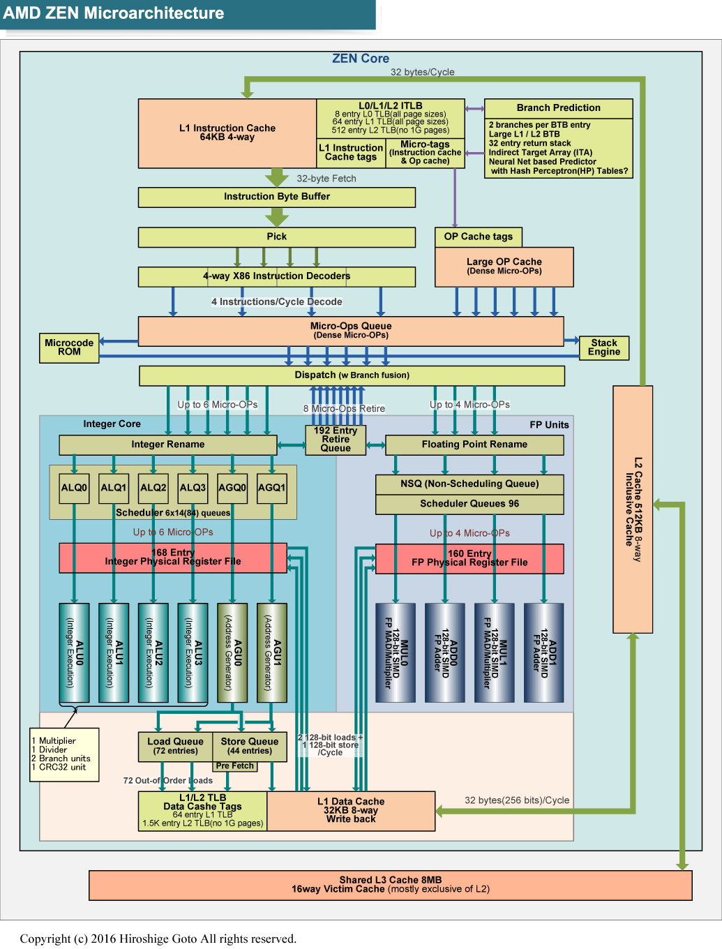

RE: AVX, that actually makes sense -the uop, retire, and store queues are statically shared but rarely used for one work load as much as they can be with SIMD. AVX, in particular, could be like issuing twice as many uops for the same task as normal, making the penalty come to light in a very clear manner.
Why would using AVX issue more uops than normal operation? At least on intel most AVX instructions decompose into one or maybe two uops, while performing 4 times (for 4x32 vectors) the work. For equal throughput, pressure on uop queue and retire queue would be reduced a lot. The bottleneck would then be the load and store queues.
This could then lead to situations where both threads are stalled, waiting for memory, but a single one with a larger uop queue would not be. For this to become significant, a hot path would have to cause this issue regularly, which should be noticable by lower power consumption (and corresponding values in the perf counters).
This could then lead to situations where both threads are stalled, waiting for memory, but a single one with a larger uop queue would not be. For this to become significant, a hot path would have to cause this issue regularly, which should be noticeable by lower power consumption (and corresponding values in the perf counters).
Because static partitioning in a six-issue queue means that each thread only haa three uop issues per cycle when ST is enabled, but six when it is disabled. This won't usually be much of a problem as the execution resources will be the bottleneck more often than not... BUT... when FastPath is in play...
...such as when AVX is used, you have a lot of macro-ops being split into two uops you can only issue two uops per cycle, instead of three uops. When you are only fetching a handful of instructions at a time, you can only fill that empty slot so well.
At least that was my thought path.
The store queue is another bottleneck in this scenario as it is also statically partitioned.
No way real way to test, though, AFAICT.

I'm not quite sure i can follow. Why wouldn't it be possible to dispatch one complete avx op (2 uops) and half of the next one (+ 1 = 3 uops)? Assuming fetch/decode is fast enough, there should be enough buffered, and if not, the wider dispatch wouldn't have helped anyway?
State sanity, predominantly, but that's a complicated matter that is very dependent on how the FastPath is implemented - and you can bet that varies by each individual instruction (dependent uops, for example, will, in effect, stay paired and are tagged for concurrent retirement - they can usually make their way however after the dispatcher, but they enter it together and retire together).
Still, even if you can issue 1.5 AVX instructions per cycle, you still have only half the instruction issue rate as without SMT. 3 uops vs 6, which will certainly have a negative impact greater than, or at least equal to, the 8-wide retire and 22-deep store queue partition (per thread). Ryzen writes back to the L1D 128-bits/cycle and the L1 writes back to the L2 with twice the width, nearly maintaining the same bandwidth as the L1D, so the data should have no issue with movement after execution.

AVX 256b uops are split up in the dispatch unit. Before they are represented by 1 uop.

I think statically partitioned resources are vertically split, e.g. one dispatch packet for one thread per cycle, or upper and lower half of the PRFs per thread. Splitting between issue ports sounds strange.

Hold on a minute - why would the dispatch bandwidth be statically partitioned? Or, perhaps, is there a source to confirm that?
Likely, though, the "vertically threaded" words means every other line in the queue belongs to a different thread (which is more Bulldozer-like... and partly negates what I was saying in my woefully sleep deprived state), so there's three potential instructions every cycle on average (CPU-z actually seems to hit this limit, though I haven't tried it with SMT disabled... because I'm stupid 😛).
Not as good as six uops per cycle, of course, but most apps can only ever hope to reach 2uops/cycle.
I think that's just an ILP limitation of the code. The formerly Ryzen crashing flops code has some paths which should go higher than 3 in ILP (e.g. FMUL+FADD) with 1T.
Mix that with Int ops and you might see 4+ with 1T and in sum with 2T.
It would seem you're right. I tested it without SMT enabled and IPC maxed at 3.19 on a single core.
That got me to thinking, though, of finding a benchmark which could do better. GeekBench 3 actually manages it. Without SMT, it hits a per-thread IPC of 4.05 (average of the peak IPC seen across all threads). With SMT, it only manages 3.1.
I measured IPC with StatusCore.
This actually makes a LOT of sense given the SMT scaling.
4.05 IPC * 8 Cores = 32.4 IPC (MT)
3.1 IPC * 16 Cores = 49.6 IPC (SMT)
SMT peak instruction throughput improvement: 53%
I will need to hunt for something that can really push more IPC... any ideas?
