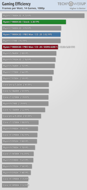

Here look at this chart
The 9600X and the 9950X are on the same process and architecture. Yet the 9600X is 92% more frames per watt. Why? It's product parameters - TDP, clock rates, etc.

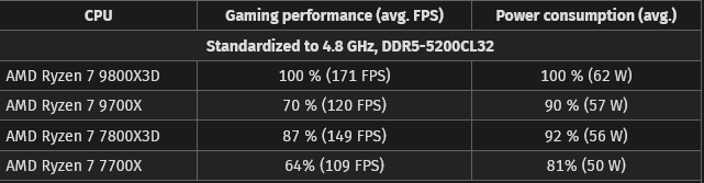

Computerbase did an iso clock comparison between 7700X, 7800X3D, 9700X and 9800X3D.
The 9800X3D gains more compared to 9700X than 7800X3D does compared to 7700X. Kinda telling wrt how memory-bottlenecked Zen 5 is.

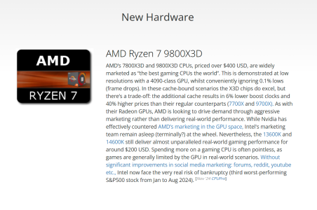

PCRag updated their review. They shilled so hard PCMR is accusing Sexton of being the owner of userbenchmark. 🤣Am I the only one that thinks the updated review is somehow worse? Esports is how they are trying to walk it back?
https://www.pcmag.com/reviews/amd-ryzen-7-9800x3d

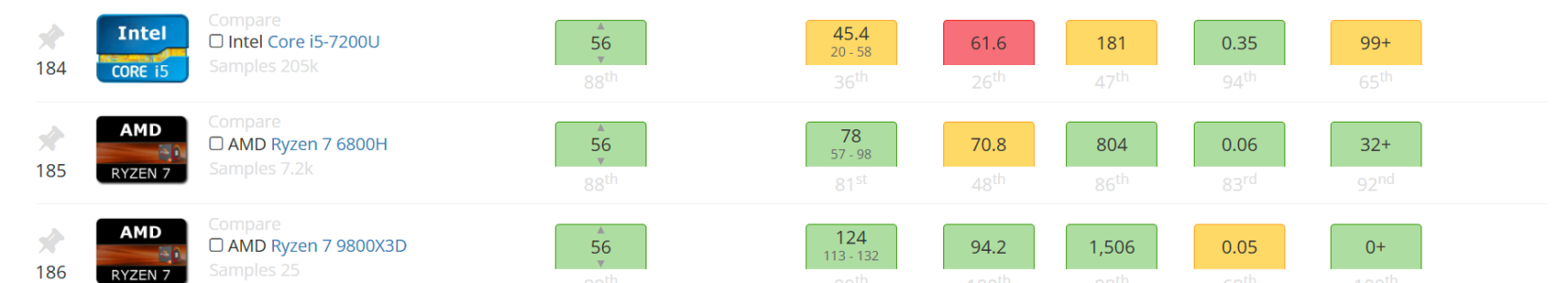

I forgot to note that userbenchmark has declared spending over $200 on a gaming CPU is pointless. Do they not understand they are hurting their beloved if they don't pimp higher ASP parts?
Hassam at Tom's covered it - https://www.tomshardware.com/pc-com...-marketing-rather-than-real-world-performance
One of the incorrigible trolls we banned here, is 💩 posting in the article comments for the 9800X3D. Good times.
