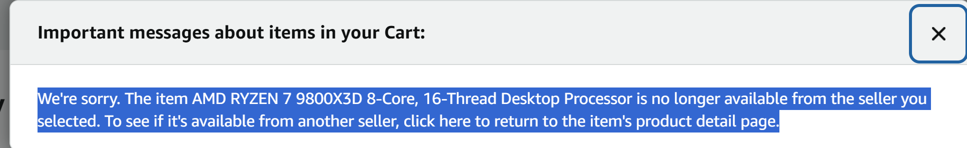

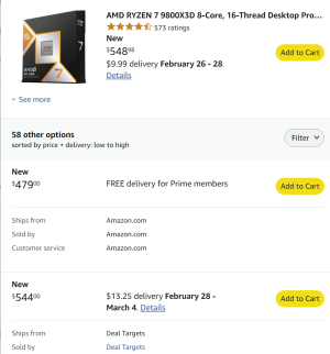

You can click on "Other Sellers", which is going to include option of placing your order with Amazon, at MSRP, which is backordered:
Sometimes Amazon lists estimated shipment date, but this time it does not show a date:
Edit: Looks like when there is no date, you can't place an order...
