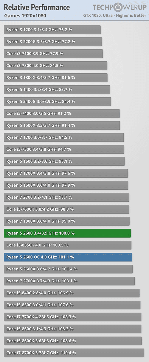

In games the 2600X behaves like a 4.1Ghz overclocked 2600. In case you're tempted to use the the 8400 perf numbers in this graph, take note they're based on using Z370 & 3200 CL14 RAM.
And how much do you think an 8400 loses in performance with DDR4-2666? About 5%, HWUB already tested this: https://www.techspot.com/amp/review/1608-core-i5-8400-vs-ryzen-5-1600-best-value/page3.html
So we are pretty much back to performance parity, with the 8400 having the pricing advantage because of DDR4 2666 vs CL14 DDR4 3200, not to mention the 8400 itself is $40 cheaper than a 2600X
And the i3-8350k is limited to DDR4-2400 at least according to intel...
What is the max OC for the i3?
Sources suggest that 4.8Ghz should be pretty easy.
If gaming is all you are after a intel quad still kills anything else AMD OR Intel in value and is even close enough to the top performance for it to not play any real role anymore,it's ~10% slower in the "kids" resolution of 1080p.
