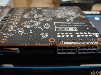

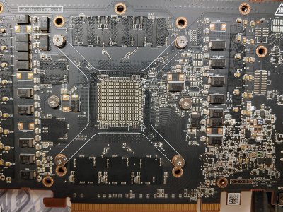

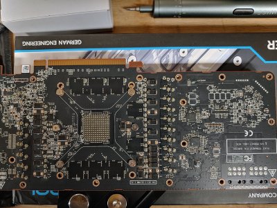

Pulling the backplate didn't really offer much in the way of answers... all looks pretty flawless to me. The dark/wet areas are where the thermal pads made contact, but those came off very cleanly. I can't see any signs of missing or shorted out components.
I'll pull the main block off next but I'm guessing this one's going to remain a mystery. Neverless, pictures!! Maybe someone who's more familiar with PCB design can spot something I can't.
So, just to close this one out but I sealed up the card with the original cooler and I've still got no video output. The die side of the PCB didn't reveal any obvious signs of why this would be the case either, but it's looking like it's certainly dead. I'll reach out to Sapphire support to see what they say but I've got a replacement card coming. Might just stick with the air cooler for now though, because that was a lot of time spent trying to figure out a mystery. If I can't RMA I'll just sell for parts.
As long as it is still under the 2 year warranty, you should be able to RMA with Sapphire, given there is no physical damage.
