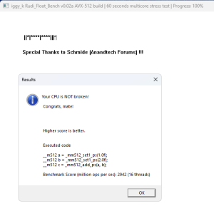

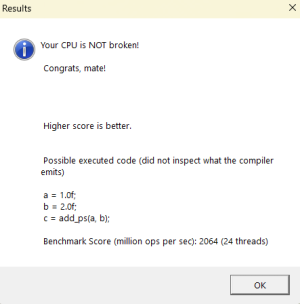

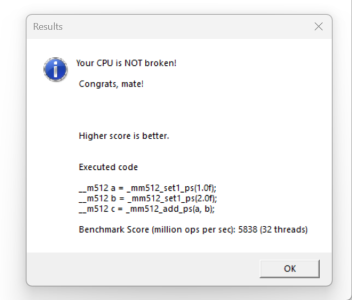

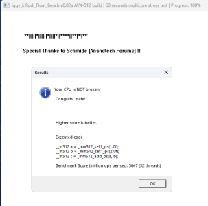

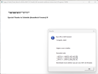

Discussion Rudi_Float_Bench v0.02a
26,866
18,489
ArrogantHair's 285K: 86 Mops / thread
My 12700K: ~65 Mops / thread
In roughly 3 years, Intel made a leap of 30% float IPC.
Of course, this is going to be a smaller gap if compared with a liquid cooled 12700K.
Reactions: ArrogantHair
