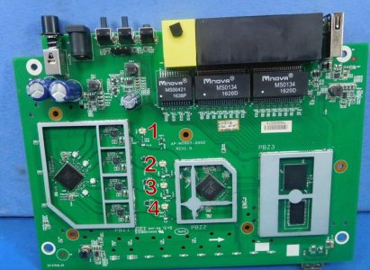

I've ran DD-WRT for many years but have not kept current on Wifi 6 router support, which not too long ago was non-existent and probably still spotty, and you don't really need wifi 6 or 7 for this purpose anway, so I'm just going to give a mention to a wifi 5 router I've had running DD-WRT...
D-Link DIR-882, in reviews it showed very good 2.4GHz (which you'd probably want for the greater range instead of 5GHz, if also bothering to add antennas for range too), range for it's price point, though it has 4 antennas (don't connect them all if you find that fewer is enough), and instead of external RP-SMA, it has internal U.FL (AFAIK) connectors which would mean that you'd need some adapter pigtails like these for an external antenna with a RP-SMA connector:
Edit: Or a U.FL to whichever connector your antennas need if not RP-SMA.
My thinking is that although there may be (usually more expensive) routers that already have the RP-SMA connectors, that going with something that has better 2.4GHz performance and adding your own, will come closer to your goal of range increase.
You'd just take the case top off to install them and while it's off, drill some (1/4"?) holes to mount those panel mount adapter pigtails. I should mention that I've never taken the antenna connectors off mine, so I can only assume these are U.FL connectors and not MHF4. IDK of any wifi device I've had that used the MHF.
If you're patient, you can probably pick up a used one on ebay for $10 + S/H, or <=$40 delivered most of the time.
The other hardware you mentioned and Win7, don't matter. The wan port on it is only 1Gb, so if you're using this to route an ISP internet plan of 1Gb, it will be a small bottleneck, but much more of one with a >1Gb plan.

I'd rather not have to open the enclosure to deal with those small PCB connectors. Too fragile.
That's a older Router isn't it? And yes. 2.4GHz is fine. The higher you go, the less range. RF 101.

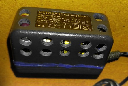

Irony. I might have just had a Netgear switch, AC/DC adapter fail. A PC connecting through it hadn't had any noticeable side effects yet, but a TV flashes a network cable disconnected, then 1/2 second later, network cable connected, message about once every hour or two, then I ran a continuous ping test and sure enough the PC experiences the same fraction of a second network dropout.
I swapped in a different AC/DC adapter to make sure the problem goes away before doing an autopsy on the original adapter.
Edit: Time Lapse... yeah, problem went away with the replacement adapter, popped open the Netgear adapter with pressure from a bench vice and a chisel, and it had a vented high side Capxon KM 22uF 200V and low side Capxon KF 470uF 25V. Replaced them with what I had in stock, Nichicon UCY2D270MPD 27uF/200V and Panasonic EEU-FS1C122 1200uF/16V. $1.68 capacitor upgrades that'll probably last a lot longer than the originals, also considering lower heat buildup...
Drilled vent holes in casing and glued it back together with PVC cement... it's probably ABS, not PVC, but PVC cement does a good enough job.
This is so ironic that I'd call shens based on the timing of the topic, if anyone else had posted it. I can only wonder if Bruce is cursed and this curse extended across the internet, lol.
Then again I probably have 20 things using a similar AC/DC adapter, but the timing, and being Netgear no less, pretty spooky. It was due to happen though, all my netgear Gb switches are over a dozen y/o AFAIK.
