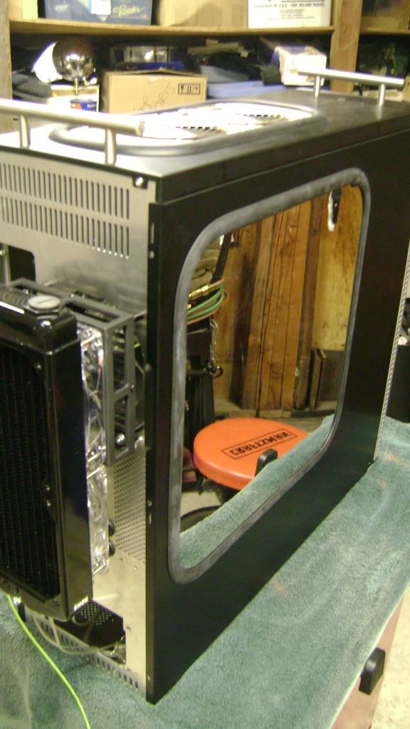

One thing I'd like to do to this case is put in a side window. I've not done this... But one would think it would be pretty easy to do with aluminum doors. What would you recommend for buying a kit on line or buying a sheet of Plexiglas yourself? Maybe a link to good place to buy parts?

A window in the left panel would be an easy mod. Cutting the hole is simple enough.... the tough part is the attachment of the glass (plastic) and making the edge look nice.
On a previous case mod, I found a large, thin, picture frame. I cut an appropriate sized square opening, and attached the frame on the outside with a series of small screws from the inside. There are a countless number of different looking frames that could be used. On a different mod I used the outer frame and glass from a wall clock.
