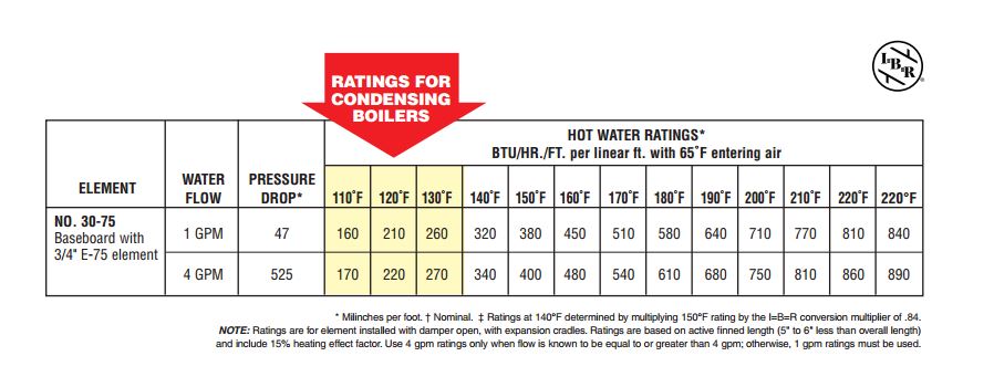

In order for you to get the 95% efficiency out of a condensing boiler, the radiation in the home needs to be adequately paired with the boiler and match its characteristics. You wont get into the condensing zone unless you return cold water (I beleive below 120 degrees). Ive heard many stories of guys being sold condensing boilers and paired with old school slant fin convection type of baseboard radiators (judging by your current boiler, sounds like you have these in your home). If you dont deliver cold water back to a condensing boiler, you will never acheive the efficiency ratings you were sold and have just wasted money. Besides natural gas is pretty cheap so I dont mind saving thousands of dollars up front and straying with an 80%+ efficiency boiler vs spending $16K for a fancy condensing high efficiency boiler that promises 95%. Not saying there is no place for condensing boilers and they are perfect for high thermal inertia applications like in slab radiant floor where the return water will be what the boiler is asking for, I'm not an HVAC guy but know enough through my own research as I had a boiler replaced recently; so take my writings here with a grain of salt and do your own research.
You have a 2008 vintage water heater that will in the next 5-10 years likely need replacing and IMO its prudent that if you are replacing the boiler now, to factor in for domestic hot water replacemnt as well. You can only replace the anode rod so any times on a standard tank before somethign else expensive also goes. What I did was get a non-condensing boiler, also a weil mclain cgi natural gas unit; my radiation in habitable areas is baseboard convection. I had the hvac guy plumb a circulator for this zone and then plumb an extra zone with a circulator for the hot water heater to stay dormant. My standard gas fired water heater was kept in service until its death. When that time came, I replaced that tank with an indirect fired water heater (a Superstor) and used the dormant zone on the boiler for this to heat the tank. Im not a fan at all of the tankless water heater systems, whether separate or built in to the boiler as a combi unit. I'm also in NH and we have hard water which degrades the internals of these heaters. IMO you should should stick with your second idea but consider plumbing in for a future indirect. Mine works very well with my weil-mclain and I have limitless hot water without worrying about what hard water is doing to my system. Ive been very happy with my Superstor and comes with a lifetime warranty.

This is a good graphic to share concerning the bolded text. You get remarkably less BTU ouput from baseboard fin at lower temps so it makes sense to need more linear footage to satisfy the heating demand of the structure. Its such a radical departure, these condensing boilers, from established practice. Conventional boilers deliver hot water at 180+ to the heating loop and are tuned/sized to not allow water below a certain temperature to return to the boiler, at risk of cracking the heat exchanger from thermal shock at worst or the moisture condensation causes premature corrosion shortening system life. Condensing boilers demand low temp return and by condensing the moisture out of the hot exhaust, utilize the latent heat available when the moisture undergoes a phase change from gas to liquid and pass that heat to the heating fluid. AFAIK, you can return high temperature water to a condensing boiler but will forgo the extra efficiency and it may operate at somewhere in the 80s efficiency. This is also why condensing boilers have their exhaust mechanically vented with a fan to atmosphere; the exhaust is so cold at this point that it no longer has the buoyant effect of hot exhaust and wont be able to rise up and out of a chimney on its own. Another reason why these boilers can be vented with simple PVC piping.
