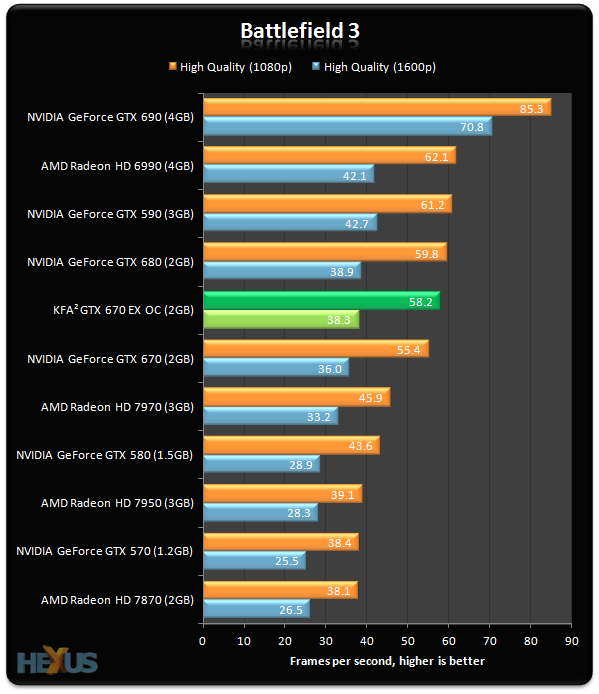

Also, while Q9550 @ 3.5ghz might not provide the same minimums in BF3 multiplayer, HD6950 is lucky to get 30 fps avg in BF3:

Your 56 fps BF3 is for SP not MP
My q6600 @ 3.4 just bearly managed a 30 fps. Min fps would obviously dip below that, and did so quote often, especially on 64 player maps. A 9550 would be marginally better but still have low minimums.
How many games can a 6950 not break 30 fps on? Zero, because those settings can be manipulated.
Bottom line is if he wants more eye candy get a GPU if you want smoother gameplay get a CPU. Like I said there are exactly 0 games that a 6950 cannot provide perfectly smooth game play in) the same cannot be said for the CPU. If the OP is trying to turn up the eye candy and is having trouble doing so with adequate performance, GPU is what he should get. If the OP is looking for more performance regardless of his settings, meaning even at lower settings the performance isnt where he wants it, CPU will do that.

Most games need a higher performance GPU as they are GPU limeted. With the GTX670 you'll be able to raise the IQ settings in games and still have higher performance than with the HD6950.
BF3 MP, especially in open 64 player maps (Caspian Border for example) it needs 6-8 threaded CPUs + high performance GPUs. If you play BF3 MP more than other games buy an 8-core AMD FX or Intel 8 threaded CPU.
