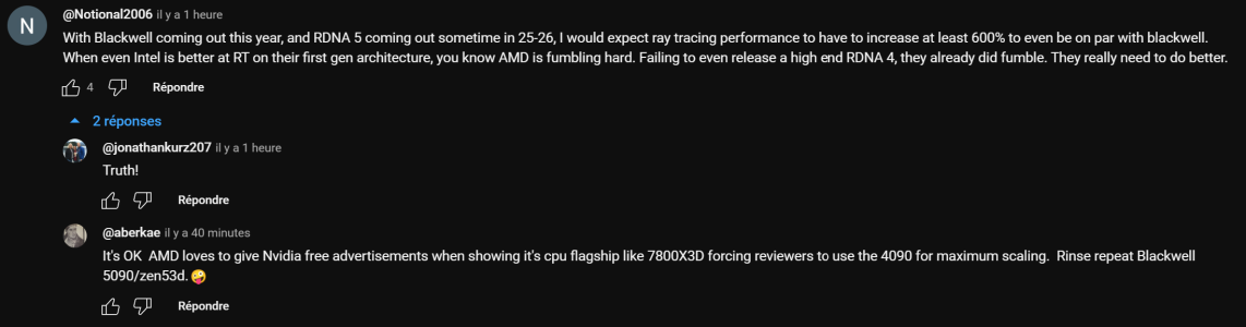

600% increase in RT to be on par with Blackwell.
You heard it at RGT's first!

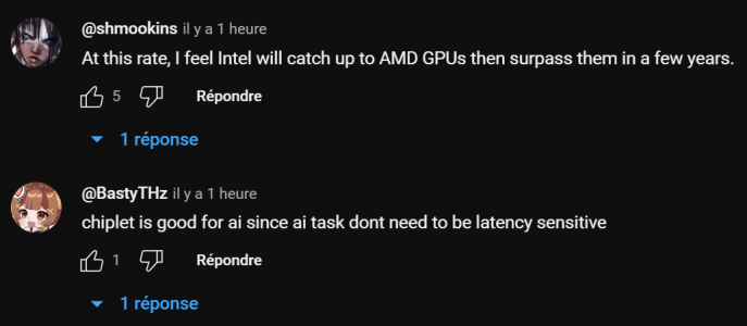

"Intel is just better as Alchemist has proven"
"AI doesn't care about latency so just kill the latency with your latency heavy chiplets"

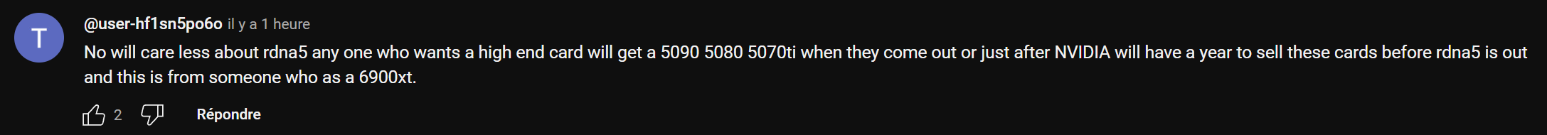

Someone who as a real 6900xt that really exists and as no reason to buy anything but Nvidia but as a 6900 xt because here is no reason to buy high end AMD.
He could stand to ave a english lesson too.

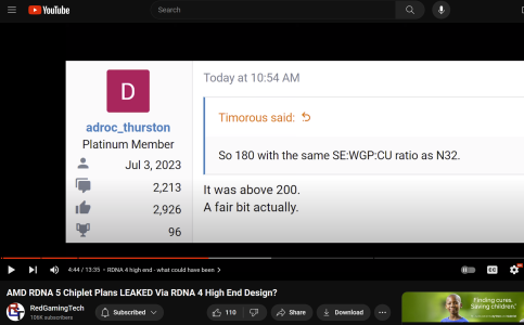

Shader engines. N44 has 2 N48 has 4. The code shown has SEs 0 through 8 for 9 SEs which would be a 144CU (or 180 if they had the same layout as N32) design and would fit with the 3 GCDs of 3SEs each that was rumoured for N4C ages ago.

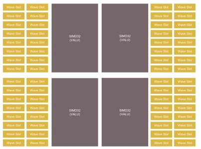

Im talking most basic fundamental level. Amd executes workloads in groups of 32 threads(32wide) each capable of same result calculation on port0 + port1 (dual issue).
16 wave per SIMD(VALU)
4 SIMD per WGP
1 (INT32 Ops per Clock (ADD) x16 (wave) x 4(simd) x 64cu x 3050mhz )x2 (dual issue) =25 TFLOPs INT32
2 (FP32 FLOPs per Clock (MAD) x16 (wave) x 4(simd) x [32WGP (2 wgp per cu)=64CU] x 3050mhz )x2 (dual issue) =50 TFLOPs FP32
=4096(VALU)
Each 1 VALU can do 2 fp32 FLOPs per clock or 1 int32 ops per clock.
They either
- increased wave count from 16 to 32
- Made the simd 64 wide instead of 32 (simmilar to GCN)
- increased WGP per shader engine from 8 to 9
- Got rid of dual issue on port0 and port1
All this points to ~2700-2750mhz boost
Or left it as in rdna3 and the clock is 3050mhz but its highly unlikely too high boost clock.
Or the 50TFLOPs leak is just bs :)
