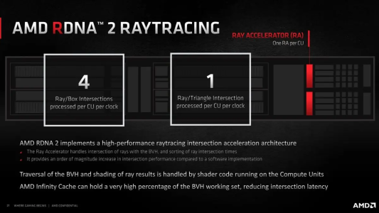

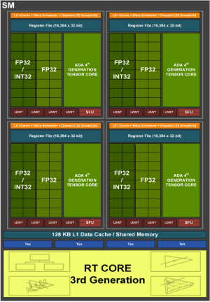

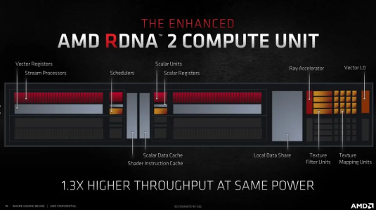

FWIW, @Kepler_L2 compiled a quick comparison of the box and ray intersection capabilities between AMD and Nvidia's GPU architectures (see below). If I'm not mistaken, this is a RT unit vs RT unit comparison and RDNA 2/3 has two RT units per WGP while Nvidia has one RT unit per SM (WGP has 128 FP units while SM has 256 FP units). What AMD is missing is that hardware BVH walker or traversal unit, which will be finally added in RDNA 4.
RDNA 2 WGP:
Ada Lovelace SM:
EDIT: Dang, seems like I need to do more homework into how RT works but I found an informative Reddit post which sheds a little more light.

It is funny how Box-oriented AMD is actually.
Wonder what got them to do it this way...
The more I read, the more I am now believing that ray-box intersection tests is what speeds up BVH traversal. As I understand it, the BVH structure is comprised of mostly boxes within boxes, where triangles are in the last boxes at the bottom of the tree, although it largely depends on how the BVH structure is built.
You can have a relatively wide but shallow BVH structure, or a narrower but deeper BVH structure. Wider structures have more boxes in each level, thus requiring more ray-box intersection tests to get to the next level, but a deeper BVH requires more jumps because there's simply more levels and more jumps means more demand on the cache/memory subsystem (every time you drill down a level, you need to jump to a new memory address as far as I understand). It's apparent that there's a balance between the two approaches.
The goal is to identify as quick as possible which triangle gets hit by the ray. Having more ray-box intersection lets you get through the levels of boxes quicker, and having more ray-triangle intersection helps you identify the final triangle in the last box quicker.
Seems like AMD prefers the approach of a deeper BVH structure, which puts more pressure on the cache and memory subsystem, while Nvidia prefers a wider but shallower BVH structure. The former is a very CPU-like approach to things (RDNA 2 has a souped up cache system, thanks to AMD's CPU team involvement in the design of RDNA 2) while the latter is a very GPU-like approach, given that GPUs have a ton of compute and memory latency is high.
Can't speak about RT, but I know BVHs from back when I was studying game physics.
It's essentially a 3D space divided into 8 (yes this is divided into more than that, I couldn't find a clean picture).
You divide the top level bounding box, which contains your world (for physics not RT), by its center point. Divide it in 3D, and you get a X, Y, and Z axis dividers. These create 2 boxes top forward, 2 boxes top back, 2 boxes bottom forward, 2 boxes bottom back. If you can visualise that.
These boxes have effectively divided your world by 8, which is necessary for physics since you can't have every single dynamic thing in the world collide with every single other thing. You divide them into usable areas.
A BVH is a structure that holds these "divisions" of the world, and tests them(I.E stores what elements are within the bounding box) when a ray passes through. I'm not too sure if it's based off the camera's viewport or the world, I imagine the world but I don't know.
I'm guessing that "8 Boxes" means that the world gets divided 8 times, and the Hierarchy thus can divide by 2^8, so 256 times more precision. Which means that you greatly lower the number of needed calculations because you can get a much more precise idea of where the ray will collide. However, I'm not too sure on 2 triangles. It returns 2 triangles hit by the ray, I guess? So it lights them up together?
The goal is to identify as quick as possible which triangle gets hit by the ray. Having more ray-box intersection lets you get through the levels of boxes quicker, and having more ray-triangle intersection let's you identify the final triangle in the last box.
I'd say the opposite, more ray-box intersections means more boxes, means longer times to get through. Which would possibly explain why they waited to have a BVH walker to go up to 8 Box, but then again NV doesn't seem to give a damn going beyond 4.
I'm gonna need a hand on guessing what ray-triangle is, if it's not one triangle and its nearest one, or going through one triangle. But I really don't see why NV would go through three triangles, so probably it's just a triangle and its neighbour.
Edit: it would be quite consistent with the general company philosophies that AMD's BVH is more precise but also heavier on the HW, while NV goes for more triangles and loses precision. No proof of it or anything, but if you look at how much AMD cares about FP64 and how much NV cares about FP8, I'd say I'm probably on the right guess.
Edit 2: now that I think about it, a 8-deep BVH would have an insane amount of boxes to store. Forget walking through it, it would already take a crazy amount of VRAM space.
If every box division yields 8 times more: 8^8 = 16,777,216 boxes. I suppose they can have a smart structure that just erases/ignores the empty boxes, but still. 8^4 == 4096 volumes for comparison.
As far as I understand it, that is correct. A binary BVH structure has 2 branches per box (aka BVH2), BVH4 has 4 branches per box, and BVH8 has 8 branches per box. I don't necessarily agree that a higher branching factor is "more accurate" because whether you split things into 2, 4, or 8 boxes you still have to traverse down to the final "leaf" node to find the triangle the ray intersects (or doesn't intersect).
More ray-box intersection capability just means you can get through more box intersection tests per cycle. That's it.
Again, I'm not sure "more precise" is the correct way to see it.
It's a matter of width vs. depth. In theory, if you have a higher branching factor, meaning each layer is wider, you should have less layers in general because of how finely you are chopping up the space.
To use your example, you can get to 4096 volumes using BVH2 (12 layers, 2^12), BVH4 (6 layers: 4^6 = 4096) or BVH8 (4 layers: 8^4 = 4096).
I was doing more reading and came across this article. It helped me understand some of the theory.
