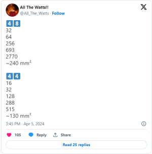

"RDNA 4 specs and performance prediction
A similarly clocked RDNA 4 CU is 12% faster in raster and 25% faster in ray tracing compared to RDNA 3.
That would put:
- a full Navi 48 SKU close to a 7900XT
- a full Navi 44 SKU between a 7600XT and 7700XT"
The link they shared:
"The traditional performance IPC of RDNA4 is expected to increase by about 12% compared to RDNA3, while the improvement in light pursuit will be huge (hardware BVH traversal), and the IPC is expected to increase by about 25%.
RDNA4 should be a single-chip design, using TSMC N4P process, with a smaller area, so the cost is very low. The video memory should be GDDR6. The graphics card will be very cost-effective."
branch_suggestion
Aug 4, 2023
880
1,931
N32 is 36.3B* xtors at 103.7M xtors/mm^2 overall, for N48 being monolithic, adding 1SE and 2WGP's but taking out the USRs plus estimating other uArch changes puts it at ~34B xtors or so, about 140M xtors/mm^2 at 240mm^2.
N31 is 109M xtors/mm^2 overall, 150M xtors/mm^2 GCD
AD102 is 125M xtors/mm^2
AD104 less at 121M xtors/mm^2
GH100 98M xtors/mm^2
B100 looks to be 125M xtors/mm^2, uArch changes make up most of that gain
But finally, looking at other N4 parts, PHX1 is 141M xtors/mm^2.
So I think Greymon 2.0's leak is plausible.
*Yeah TPU needs to do a far better job at keeping their database up to date, N48 needs to have slightly fewer xtors than N32 to fit <=250mm^2.

If N44 is 19.5M transistors
N33 is 13.3B transistors, no way that N44, which is probably the exact same spec has 6B more xtors. Uncore will be a touch beefier maybe but the area it uses will remain similar, and remember that RDNA4 continues to gut out hardware for software where possible, offsetting xtor gains for PPC.
I think N44 will be 18B* xtors at 130-140mm^2
N48 34B* at 240-250mm^2
Basically think 10-15M more xtors/mm^2 than previous GPU's, really pushing the limits of N4P.
I trust the twitter leak over the baidu speculation.

TESKATLIPOKA
May 1, 2020
2,696
3,260
He started in a first post by stating 2770 and then in a later post he said 3GHz.
At first he aligned the datas stating 32 WGP/64 CUs/256b bus/693GB/s /2770MHz/ 240mm2.
His first post explicitly mentioned die sizes, the rest were only numbers.
2770 for N48
515 for N44
You come up with a theory that It was frequency not caring that the numbers were hugely different.
It cant be more clear than this, 2770GB/s as you stated would imply chips with roughly 100Gb/s speed while a 7800XT FI use 20Gb/s speed chips, you can see the huge discrepancy.
I was talking about IC BW -> Infinity cache bandwidth.
And yes, there is a huge difference in BW depending on how much MB cache there is.
