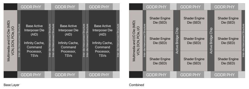

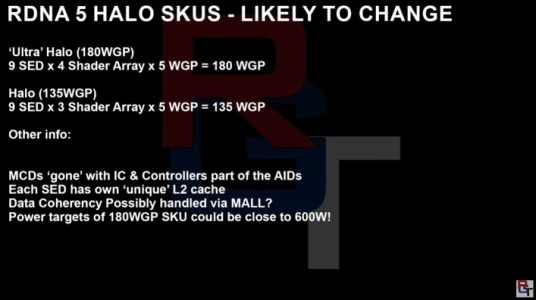

Meanwhile...
So, assuming this isn't just someone's hopeful fantasy, could it be that the ASIC known as "Navi4C" (or whatever it called now) was originally planned for the RDNA5 launch schedule?
TESKATLIPOKA
May 1, 2020
2,696
3,260
Is It even worth It to post It here? It's pure speculation based on N4C and not even a good one.
Just looking at the second one It's clear he is talking nonsense. There is no reason for AMD to have two different SEDs, or rather for that second one to be using 9 smaller SEDS instead of 7 bigger ones in my opinion.
Regardless, If AMD releases such a product, I have to wonder how the other models would look like. 3-6-9 SEDS? Other combinations? Based on performance or?
BTW, even 3 SEDs would have 25% more WGPs compared to N31 in case It's 20WGPs per SED.

PJVol
May 25, 2020
854
838
Why not? Isn't that what this thread is for?
Are you sure that your opinion is backed up enough tech-wise so as not to look plain stupid later?
Reactions: SteinFG
Tuna-Fish
Mar 4, 2011
1,685
2,572
I'd back him up on this. The big win of having a separate SED that you tile to make products is that on the leading edge nodes, chip design is freaking expensive. By only having a single such design and then duplicating it in products, you save tons of money. There's no way they are making two fairly similar ones.
If they are unsure about how high to scale the high-end product at this point, what they are uncertain about is how many of the SEDs they are going to pack in, not about how much resources each one should have.
TESKATLIPOKA
May 1, 2020
2,696
3,260
Is RTG even worth our time? How many times was he correct? BTW, he is already backpedaling in what you posted in case he is wrong.
Are you sure that your opinion is backed up enough tech-wise so as not to look just stupid later?
Are you saying It makes more sense to use 9 smaller SEDs than 7 bigger SEDs for basically the same amount of WGP(135 vs 140)? And AMD would also need to design another SED for that, that's not cheap and doesn't look like it's really needed.
So is what I wrote really so stupid? To me It looks more realistic than what he wrote.
PJVol
May 25, 2020
854
838
If you both bothered to watch the video, it says that the info comes from different sources, or rather, one of them is more up-to-date.
Our? Anyway, it's your own business. Personally, I don't see how his info is less relevant than most people's guesswork here.
Reactions: SteinFG
TESKATLIPOKA
May 1, 2020
2,696
3,260
RTG has sources? :D
I am very skeptical. I wouldn't be surprised If his sources are actually tech forums like this one.
Didn't mean exactly you but others. I don't think I am the only one who doesn't believe in him having any real sources.
You can believe him If you want, It's your own business, I said what I think about him or this info of his.

Glo.
Apr 25, 2015
5,930
4,991
There is plenty of possibilities from engineering perspective.
9 SEDs gives you 3x3 array. What gives you 7 SEDs? How would you arrange them?
TESKATLIPOKA
May 1, 2020
2,696
3,260
With 2 different SED It would look like this:
9 big SEDs in a 3x3 array -> 180 WGPs (+33.3%)
9 small SEDs in a 3x3 array -> 135 WGPs (+12.5%)
6 big SEDs in a 3x2 or 2x3 array -> 120 WGPs (+33.3%)
6 small SEDs in a 3x2 or 2x3 array -> 90 WGPs (+12.5%)
4 big SEDs in a 2x2 array -> 80 WGPs (+33.3%)
4 small SEDs in a 2x2 array -> 60 WGPs (duplicate)
3 big SEDs in a 3x1 or 1x3 array -> 60 WGPs (+33.3%)
3 small SEDs in a 3x1 or 1x3 array -> 45 WGPs (+12.5%)
2 big SEDs in a 2x1 or 1x2 array -> 40 WGPs (+33.3%)
2 small SEDs in a 2x1 or 1x2 array -> 30 WGPs (100%)
What SKUs would you make out of this? Performance jump would be uneven, either too big or pretty small, there is even a duplicate there. I personally wouldn't bother designing another SED for this.
BTW, why should we be limited to 3x3, 2x3, 1x3, 2x2, 2x1 arrays?
There is nowhere written that you can't have 1,2,3,4,5,6,7,8 or 9 SEDs.
Why can't I use 7 SEDs for example? Because It doesn't look pretty? 7900XT or 7700XT also have an uneven number of MCDs and no one cares.
It's not like you can't have a single SED in the last row(column) and instead you are forcing yourself to design another SED.
Glo.
Apr 25, 2015
5,930
4,991
Most likely - interconnects, and how they are placed on the dies.
If I understand this correctly - its possible to reuse the SEDs on different types of products, so AMD would want to aim for best possible interconnect for the dies.
Single die could be then used in an APU, the same way they could be used for dGPUs. So AMD has to design ONE die to scale it from APUs to the dGPUs. But it will require stupidly complex interconnect.
TESKATLIPOKA
May 1, 2020
2,696
3,260
A 7 SED GPU would have the same placement as a 9 SED one, but 2 chips will be missing in one row or column.
Basically the same as we already have with RDNA3 MCDs.
If the problem is with the AID under those SEDs, then that would mean you are basically limited to 3-6-9 SEDs, then why not do just SEDs with 3x more WGPs for 1-2-3 SEDs in total?
For any different combination you would need a different AID(active interposer die) and If you add a different SED, then even for that.
Glo.
Apr 25, 2015
5,930
4,991
I presume you need coherency of data, so the layout has to be symmetric.
Potentially this may be requirement for scalable geometry, if you think about it.
