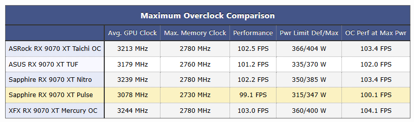

And why do you think at 200W It won't clock >3GHz?
Average GPU clock for 9070XT after OC -> limit 404W max.
Even 200W is more than this should ever draw.
7600XT had 190W TDP while 7800XT had only 263W. If they need the extra performance then 200W is quite possible.
