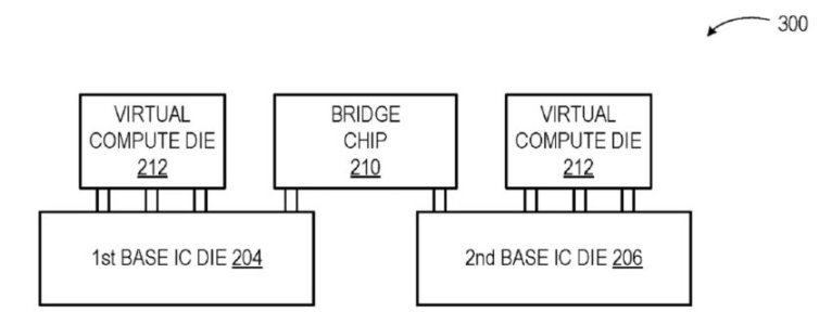

Let's hope RDNA5 with 2nd gen chiplets design performs better. By combining multiple MCD into one base die definitely provides better power efficiency. The same should be apply to GCX, AMD should/could combine multiple SED into single die of GCX, that saves lots of power rails while simply the packaging.
With one GCX, I could estimate single die of GCX to have around 70 CU and 150mm2 die size with N3E process. Each GCX with base die should connect to 128-bit of GDDR7 memory support.
When I was searching for Navi4C design photo, I was shocked to find out the pattern photo which explain above design:- :eek:
Yeap, the design of Navi4C was definitely too complicated and power hungry; RDNA5 would most likely using above designs with bridge chip to communicate between each die. Too bad we won't be seeing it until 2025 but if AMD got it right, then AMD has the upper hand of future GPU design which is definitely heading towards chiplets...

Let's hope RDNA5 with 2nd gen chiplets design performs better. By combining multiple MCD into one base tile definitely provides better power efficiency. The same should be apply to GCX, AMD should/could combine multiple SED into single die of GCX, that saves lots of power rails while simply the packaging.
I was also wondering about that. The only reason of having multiple SEDs stacked on top of a single die (AID) would be if AMD had plans to somehow reuse the SEDs or to stack different number for segmentation.
Otherwise, it seems it would be cheaper to have a single bigger GCX rather than multiple SEDs
With one GCX, I could estimate single die of GCX to have around 70 CU and 150mm2 die size with N3E process. Each GCX with base tile should connect to 128-bit of GDDR7 memory support.
Yeap, the design of Navi4C was definitely too complicated and power hungry; RDNA5 would most likely using above designs with bridge chip to communicate between each tile. Too bad we won't be seeing it until 2025 but if AMD got it right, then AMD has the upper hand of future GPU design which is definitely heading towards chiplets...
I don't think it is that complicated, once you get over the challenge that they can bridge 2 chips and have silicon bridge that uses hybrid bond. I thought challenge of this might be thermal expansion, but if they have it figured out then it is just a new way to put the Legos together.
With the chiplet approach, with 4 dies, they can assemble large number of SKUs, while optimizing the silicon for its optimal use.
Logic scaling is still continuing, so taking analog and most of SRAM out of the SED/GCD, AMD should achieve excellent transistor densities. While being able to add a lot of SRAM on the least expensive silicon.
As far as power hungry, all of the hybrid bond connections have extremely low power overhead. Almost like being a single die.
If AMD does add a substantial amount of cache, such as 2x of Navi 2x equivalent, that actually saves power, because the cache hits would eliminate memory accesses, which are a lot more expensive.
Well, it is definitely more complicated than new design. Anyhow, with Mi-300 like design, I could see AMD working on the successor of Navi4c, let's call it Navi5c for the moment. If AMD decided to make mega-GPU with 4 base dies, then they might need to add additional bridge chip to connect other dies like "X" connectivity between 4 dies...hmm, so each base die required to have 2 bridge chips??
As for amount of cache, if each base die have 32MB of cache, that would require die size of around 70mm2 with N6 process. So I am not sure AMD would scale up much on the amount of cache???
Anyway, I could see how much technical challenge AMD is facing, that explains the delays into 2025. But the most time consuming would be to validate design of Navi5c. If AMD managed to pull it off, then AMD should be able to launch Navi5c, N51, N52 and N53 pretty quickly.
For n number of base dies, there would be n-1 bridges.
So, if there were 4 base die, that would mean 3 bridges.
+1 bridge to connect the I/O chip.
64 MB of SRAM = 36 mm2 (for Ryzen chips with V-cache)
So in theory, there would be room for a lot of SRAM on the base die.
But curiously, the size of the MALL cache AMD has used (or is rumored to be using in future products) is very low. Including Mi300, which may have > 1,000 mm2 of silicon on the base dies
I won't have an explanation why it is low...
I wonder if the costs by that point are low enough for all of these cards to be chiplet based, from low end to high end.
I think the odds are better than 50:50 in favor.

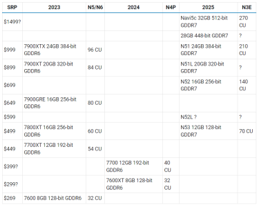

I have actually made a speculation table with upcoming RDNA4 & RDNA5 cards with price estimates:-
The total package of GCX + Base + bridges won't be cheap especially with GDDR7 memory. That's why RDNA5 GPUs are mostly covered from $500 and up. I have included the potential prices of Navi5c, it should be in range of upcoming RTX5090 ...
As I mentioned before, RDNA4 GPUs are most likely to be available under sub-$400 market segment. And they are going to live through 2026; approximate two-year shelf life. As with N32; they are going to be replaced by N53 two years later...
N33 will live longer than 2 years cause I am expecting 7600's price to drop below $200
N31 may have to drop prices sooner than we think, want to guess how much???
