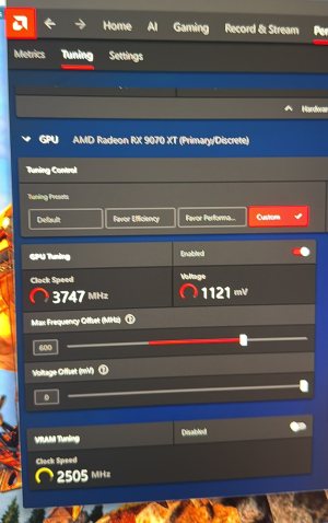

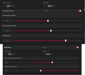

Anyway cant post screenshots for some reason.
Anyone with 9070xt if you want to see how broken the overclocking is
go to heaven benchmark near the baloon (free camera)
Set -25mV or -30mv or -35mV and +275mhz clock offset (leave the power and memory stock)
U will boost to 3550mhz then try -40mV or 0mV BAM 3300mhz
I crash at 3650mhz at -30mV or -35mV any other mV settings im at either 3250 or 3300mhz... Broken as hell...

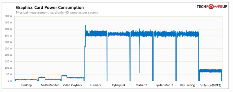

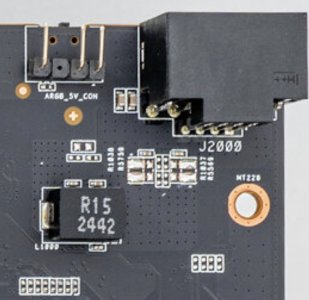

The Taichi review is up on Techpowerup with the teardown and PCB shots. Looks like it's one big power plane like the Nitro+.

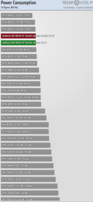

Is 60fps V-Sync going to make a comeback or what?! I mean, sheesh, 80W vs 360W? Frame-rate caps are your AC units friend, apparently. Even if you choose something super-taboo, like 85Hz + VRR, you are still going to be saving an arse-load of power and heat generation. Its actually very impressive in this regard compared to almost every other card produced. Uses like half the power that my 6700XT does when both are throttled to 60Hz.
Or one could say:
if a GPU running e.g. Apex at 180 FPS consumes 260W, then any 9070 variant should use 180W for the same job ...

Check this out 3750mhz... the VF curve is broken
-55mV 3350mhz
-40mV 3300mhz
-35mV 3575mhz
-30mV 3550mhz
-0V 3450mhz
Exact same power draw and temps in all
I can boost up to 3725-3750mhz depending on idk what tbh... sometimes i boost lower then i do pc reset and i boost higher...
Sometimes this clock behaviour also manifests itself in GAMES ! By random...
Like i set -35mV +275mhz and play game for 1-2h and out of nowhere like randy orton my card says nah RKO i hear excessive coil-whine i turn on monitoring and BAM 3550mhz and crash is imminent if i dont fiddle with the settings xD

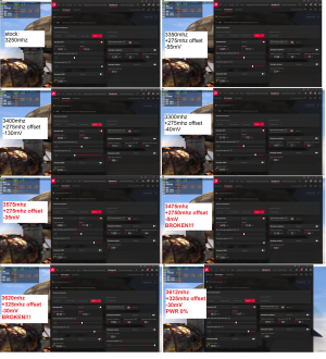

Check this out this is not normal !!
stock 3250mhz
3350mhz +275offset -55mV 324W 79C (reported 1121mV)
3400mhz +275offset -130mV 306W 79C (reported 1086mV)
3300mhz +275offset -40mV 326W 82C (reported 1121mV)
3575mhz +275offset -35mV 336W 82C (reported 1118mV)
3475mhz +275offset +-0mV 336W 84C (reported 1120mV)
3625mhz +325offset -30mV 336W 85C+10% power
3612mhz Same with +0% power

VF curve is broken... In some benchmarks/games the card undervolts itself.
Its like this turn on any game static scene dont move. Check what voltage the card reports. lets say 1125mV
So i can do -75mV "undervolt" but the reported voltage DOES not change no matter if u do -15 -20 -25 -30 -35 etc... BUT the CLOCK increase.
So if i set -75mV i gain for example +200mhz right ? Then i start playing voltage fluctuates card wants 1135mV ? BAM CRASH
If the game static sceene wants 1125mV and i do -80mV then the voltage reporting and power draw DROPS !
People think they are doing -200/-130mV "undervolts" but in reality the card undervolts itself and the setting does nothing but somehow the clock increases. with exact same power and temps.
Idk if i explain it correctly and u get where im comming from.
OH i forgot some games or benchmark it works.
Like steel nomad 3dmark for example.
stock settings im doing 0.96V or smt
But with -55mV im doing 0.89-0.9V
Thats why there are almost no people that can go lower than -75mV in steelnomad benchmark asked few hc overclockers (i can do -65mV)
Other games/benchmarks its like i explained above !

Yep im not mad
Just tested in 3dmark timespy extreme.
stock +-0mV +-0offset 0% power limit
clocks at 2950-3000mhz voltage between 0.98-1.02V
I went:
-65mV 3050mhz same voltage fluctuation as in stock 0.98-1.02V
-130mV 3100-3150mhz SAME VOLTAGE 0.98-1.02V
-185mV 3300mhz SAME VOLTAGE !!! I CRASHED reported voltage 0.96-1.0V
-180mV 3250-3300mhz SAME VOLTAGE NO CRASH
all at same temps and power kinda crazy
So 1.2V -185mV = 1.015V thats why i crashed at -185mV and not at -180mV
AND i gained stock +0mv 94.6fps -180mV 100fps just by doing this........

Is this voltage curve just for RDNA4, or will it work on RDNA3 as well?
gaav87
Apr 27, 2024
659
1,279
Rdna4 only top is rdna2/3 bottom rdna4
Just tested forza horizon5 same exact behaviour:
-0mV 3150mhz driver reporting 1046-1066mV 107fps
anything between -0mv and -85mv = 3150mhz
-130mV 3325-3350mhz voltage reporting 1046-1066mV 115fps
-135mV 3350mhz voltage reporting 1046-1066mV 117fps <- sometimes crash i can run the benchmark 5x times
-140mV 3375mhz crash almost instant
All at 0% power limit
1200mV-130mv=1070mV "safe" spot?
1200mv -135mv = 1065mV no voltage head room from what its reporting as 1046-1066mV sometimes crash
1200mv -140mv = insta crash
