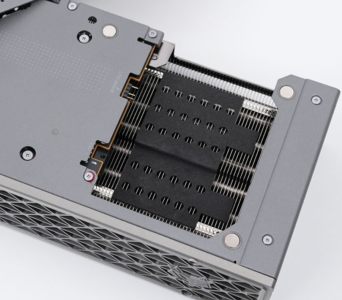

1) Placed a felt over the heatsink fins to protect them from the power cable which appears to block maybe 70% of the flow-through air

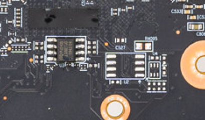

2) Designed dual bios into the PCB but left the switch and second bios chip off (Why? Is there a higher tier card above the Nitro+ coming they are trying to upsell?)

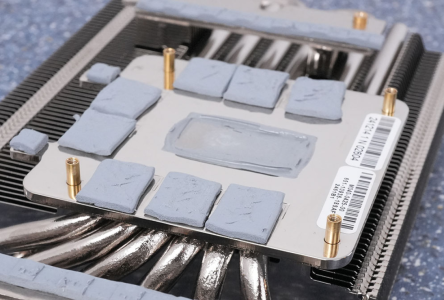

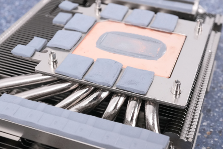

4) The techpowerup review didn't mention this, but their teardown shots show the Nitro+ heatsink being NOT evenly mounted against the die. Either it's a design flaw or the heatsink screws were loose on one side, neither of which is good.
Nitro+ - Note the right side has a thick layer of PTM while the left is pressed against the coldplate
Compare to the TUF - Note the PTM melted enough to press out and show an even, firm mount

3) Forced a 90 degree bend immediately off the connector
