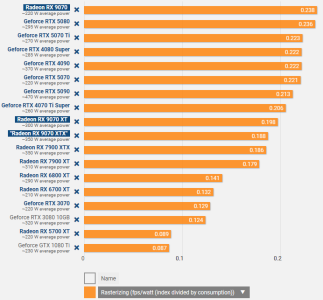

Using 1440p TPU data RTX 5080 is 9% better performance per area. While using, in theory, 20W more power and 50% more memory bandwidth.

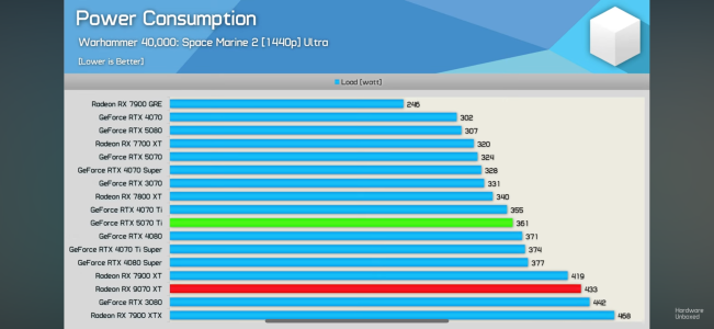

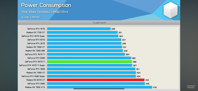

Hardware Unboxed found it significantly worse than Blackwell. They measure while gaming, not doing synthetics. It’s barely improved over RDNA 3. At least for the 9070 XT.
TPU measures on 3 games too.
Their numbers are an outlier anyway.

I’m thoroughly whelmed. Navi 48 has much worse PPA vs GB203. It’s a 5% small die but 20-25% slower. All I can conclude is that they lost a lot of PPA efficiency by just doubling Navi 44. It should be in-between GB203 + GB205 for this performance level. Closer to 300-330mm2. Also screwed power efficiency. It’s an impressive achievement vs Navi 31/32 but second place is still second place.
Its not terrible, but as we spoke of after the HWUB power leaks, theres still a good bit of distance between it and Blackwell / Ada. However, the chart above is pretty interesting, as is the perf/watt it can achieve from undervolting / power limiting, as shown in the link below.
They also measure it using a proxy, system power in only a few games which you described as heaviest sections of these games. There are sites that use pcat average across all games in their suite and it ends up much closer (to the 5070 Ti). Make of that what you will.
I don't think the 9070 XT is in the efficiency zone for N48 anyway. But it wouldn't be fair to push GB203 down below 300W for a fair comparison because it uses a lot more memory power.
If you go by HWUB alone then even the 9070 isn't efficient despite nearly every other review saying otherwise. Their method might be right. Or it may not be. But look around.

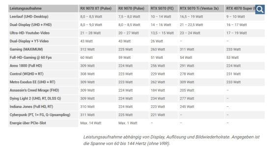

The 9070 XT has been pushed beyond its intended scope for that last 3-4% to appear closer to 5070 Ti (and $50↑ price revision), and makes it look dull imo.
The 9070 Pulse and Hellhound are MSRP, near reference designs, and both are very similar in power draw. The Hellhound is cool and quiet too. They come in at 225W sustained, while the 9070 XT is 310W for the Pulse.
The perf gap is a median +13%, and the OC models net a further 2-3% I suppose, but gets into 7900 XTX power levels for worser results in raster.
This smells like Zen 4 frequency maxing. 65W 7700 vs 105W 7700X (97% v 100%). I would take a 97% 9070 XT for 265W.

If you want a 275W 9070 XT you can probably get that with a slider in the drivers.
Usually neither AMD or Nvidia stop you from setting lower power limits.
And the sites which have tested the 9070 XT at a fixed frame rate as a proxy for equal work efficiency (TPU, CB) usually have it near the top of the charts.
