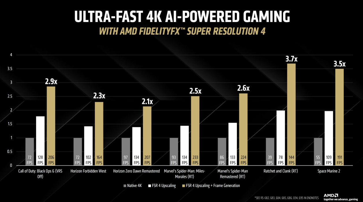

That form AMD site. Native vs UPS + FG
Thats looks bad slower than 4080 xtx 5070ti slightly above 4070tis

Spiderman RT results suspicious, almost double compare to RTX 4080
AMD saying it's maxed RT
Fabio was mention he was surprise in SM2 results even with RTX 5080
eek2121
Aug 2, 2005
3,434
5,088
It is a game designed for AMD hardware. What is suspicious?
