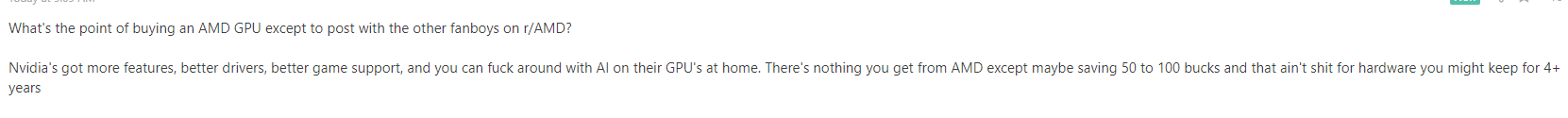

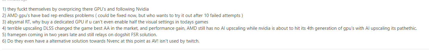

It just shows that most humans are risk-averse and change-averse. People pretending to be wise by going with the popular or trendy thing rather than experimenting and hoping to discover something new. Blindly accepting common misconceptions and falsehoods. No wonder humanity has screwed planet Earth so bad.
gonna show few examples from other forum.
and other alot examples. As you see for people only NV exist.
