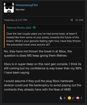

This one?
“but my confidence is way lower than my 99% I have been saying”
