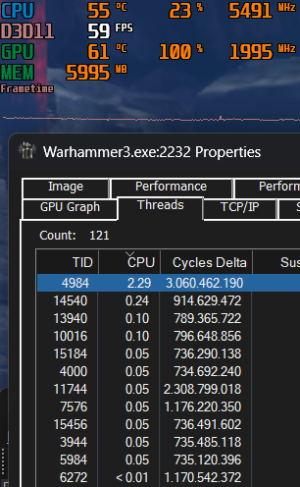

Steve was speculating how many games they went through to cherry pick? these 2. The Total War games are PC exclusives that always run great on Intel. You would think those are perfect candidates to highlight a feature like this. Must not do much for them?
If it is indeed artificially limited to 14th, that's right out of the Nvidia playbook.
Total War is bottlenecked by its Aeon old engine, likely further hampered by its Lua integration and general lack of GPU optimization. It does not create enough multi-threaded CPU load to benefit from using E cores on top of P cores, because it cannot even saturate P cores enough.

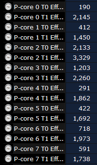

Nice work. You really have that CPU set up well. Thanks for the information. I'm currently running a slight undervolt on my 13600K with cores running between 5.4 and 5.0Ghz. That variation is due to temps, I tweak clocks to get core temps the same.
Try to prioritize non adjacent cores, preferably P cores 0+1, 4+5 and E core clusters 2+3 on your CPU. If this isn't possible due to P cores 2+3 being the best/most stable cores then at least try the E core clusters. You do this kind of prioritization by setting higher per core ratios (and then control final clocks by Turbo ratios). CPPC will make sure that Windows will schedule load on these cores first.
On my CPU P cores 2+3 are the best cores, so my priorities are 2+3 -> 6+7 -> 4+5 -> 0+1. And then E core clusters 3 (coolest) -> 4 -> 1/2.
This makes sure that there are idle cores in between busy cores, which makes a *huge* difference in temperature compared to running the same load on adjacent cores (hotspots).

Hulk
5,232
3,877
Here are the avg core temps and frequencies as I have them right now during a CB R24 MT run. Cores 0 and 1 are so much cooler than the rest. I realize there is thermal conduction among these cores. Wish I knew where they were located on the die.
Core 0 5.5Ghz 72C (This seems to be my best core)
Core 1 5.4Ghz 73C
Core 2 5.1Ghz 75C
Core 3 4.8Ghz 77C (This is the other hot one)
Core 4 5.2Ghz 75C
Core 5 4.7GHz 78C (This one I call "The Furnace Room")

Cores 0+1 are cooler, because they are at the edge of the cores area, they only have neighbors on one side. Look for die shots of the 13900K, that should give you an idea.
