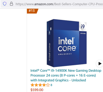

The 14900k seems to be selling pretty well, for a halo product. Wasn't it #5 on the Amazon Top10 list shortly after launch? The margins on that chip are probably not that good - it's just a 13900ks with ~$200 knocked off the MSRP. But, if we're just talking volume, hey not bad.
Reactions: Hulk

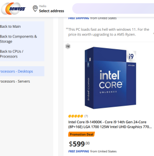

Mind blowing that 13900K is outselling 14900K on both Newegg and Amazon. It’s only $35 extra for what is essentially a 13900KS.
The day 1 reviews really killed that SKU.
Based on the reviews I've read as well as many forum threads I can't decide if the 14900K or 13900KS is the better CPU? Only $10 difference at MC so price is essentially a wash.
I think the silicon lottery makes them pretty much the same as you can get a "good" or "bad" sample of either. Crappy samples have VID's at 6GHz as high as 1.5V while golden rare as hen's teeth samples can be in the low 1.3V range. Most samples I've seen in forums seem to be about 1.42 to about 1.48 VID at 6GHz. But as we know the VID doesn't tell the whole story as some with high VID at 6GHz will run at low volts at 5.6 to 5.8 range.
My opinion is that the power gets so high on these parts once you get over 5.5GHz it's just not worth it so at the end of the day I might save a few bucks and move from my 13600K to a 14700K. I'm going to sit back a bit and let prices settle.

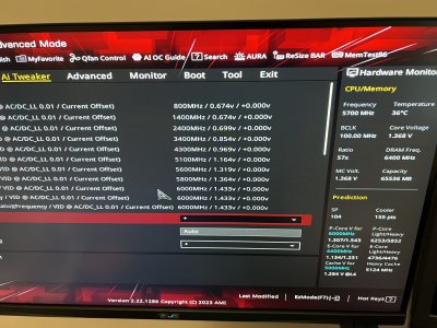

Just to give you some first hand experience - I've got a 14900K and this ended up being my VID. I've got more money than sense and this is my hobby so I don't really care about the $600 for a minimal upgrade.
When comparing against my old 13900K (SP 96) this is what I've noticed.
Memory Stability at default IMC Voltage (64Gb Hynix A-Die dual rank):
13900K - Barely stable at DDR5-6600. The default IMC voltage was 1.389V. I mostly ran it at DDR5-6400 just for peace of mind and 100% stability.
14900K - Stable at DDR5-6800. The default IMC voltage is 1.368V. The same tests that would error within minutes at this speed now can run for hours at a time. It's been a week of multiple reboots / retrainings, stress tests and gaming with zero errors.
Clocks:
13900K - 1.449V VID for 5.8ghz (stable undervolt was -0.040/-0.020 for P & E cores respectively)
14900K - 1.433V VID for 6.0ghz (stable undervolt is -0.050/-0.0330 for P & E cores respectively... I could push it further but it's just not worth it since I've never seen a temperature exceed 83* C at 253W)
With both CPUs capped at 253W, I get ~140-180mhz more frequency at same power consumption and 10-12*C lower temps. I would advise most people with 14900K to just cap E-cores at 4.3ghz (it's what I did) since it lowers power consumption and enables higher boost on P-cores with the same PL2.
