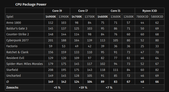

It seems like for 14900K, all we got was a test of everybody’s coolers. The only person that got results that matched my expectations was Jayz2Cents but he’s pretty unreliable so I don’t want to read too much into it. The only thing that remains constant from all reviewers is that when limited to 253W RPL-R will run 8-10* C cooler.
For the 14600K there’s a clear trend where it has both higher frequency and less power consumption. I don’t think I’ve seen a review where the 14600K consumes more power than a 13600K.
For 14700K when compared to 13700K it also appears to have higher P core frequency when both are running at 253W. Even ComputerBase’s numbers which IMO are trash tier for this release show a slight frequency bump for 13700K at isopower.
Computerbase has the 14600k using more power but TPU has it using less, so, *shrugs*.

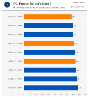

From Techspot: https://www.techspot.com/review/2749-intel-core-14th-gen-cpus/
Look at the power consumption of 14600K vs. 13600K and 14700K vs. 13700K.
3.48% and 3.78% less power consumed by the newer P-cores.
I think this is evidence that 14th gen is better binned silicon.
As for 14900K consuming more, maybe they got a bad sample or TVB is messing up the power numbers or since they let the mobo manage the voltage, the 14900K is getting overvolted?
Reactions: Tlh97 and Mopetar
It’s same p cores. I’ve got no idea why the performance isn’t the same across both RPL & RPL-R.
Nice summary. Thanks.
If the 14900K is running cooler than the 13900K and both are always thermally limited then the 14900K should be showing consistently better performance as it would be running at a higher frequency, right?
You’d think so. I honestly can’t make sense of any of it.
