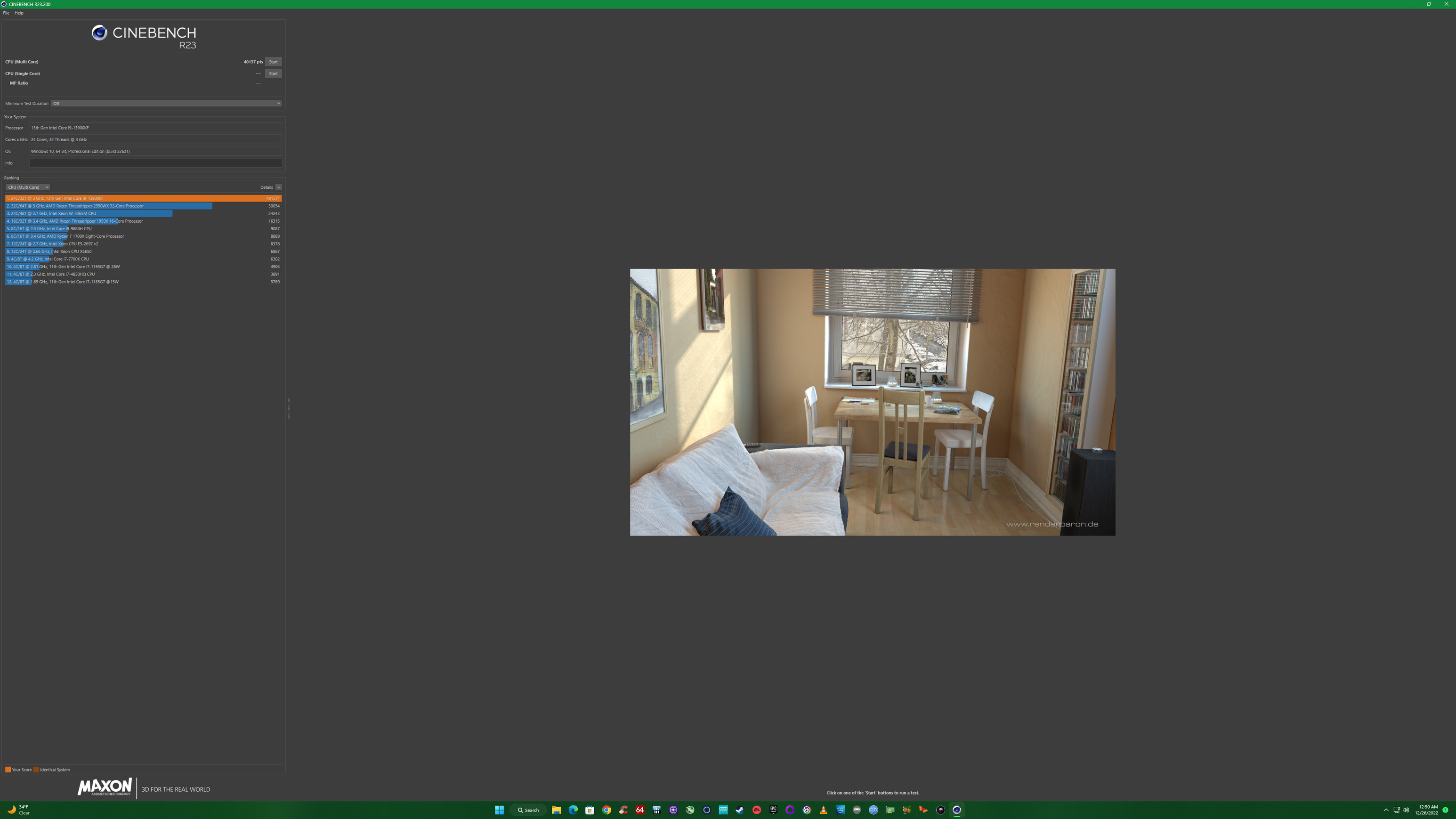

Finally got into the 40K club for CBR23. Took 5.4ghz to get there, and 235w. Voltage is still the same, which furthers my earlier point that Raptor Lake is limited by power draw and not voltage.
*Edit* Ran HWinfo during multiple CBR23 runs and apparently I wasn't hitting 5.4ghz, much less sustaining it. It was mostly at 5.3ghz. Apparently more power is needed to run 5.4ghz all core boost but with my cooling it's not worth it.
5.3ghz is definitely the sweet spot for me.
Is HWiNFO reporting 235W for a 40K run?
