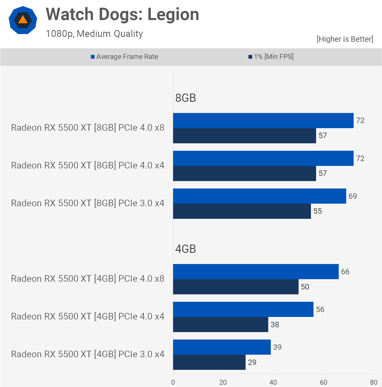

This really just seems like a terrible card from every angle. Tiny 64 bit memory bus. Crippled media encoder/decoder section, 4 Channel PCIe bus.
I can't imagine they would have built something this bad to sell for more than $100 in normal times. Going for $300-400 it's a sad joke.
I'd just stick with an iGPU to ride out these times, even if it meant not playing any games from the last decade, rather than buy this thing.
I'm not sure if the PCI lanes will really cause much of a problem unless using an older board that doesn't have PCIe 4.0 on it. Unless the card doesn't have enough VRAM, the PCIe bandwidth isn't particularly important. TPU did some tests on PCIe scaling with a 3080 and it was a lot less than you might imagine.
There's also a question as to how much the infinity cache (even as small as it is) will help alleviate the issue. The far bigger concern is going to be the 4 GB of VRAM, which when looking at the HUB video seems to be a far bigger issue in many games or some games at particular resolutions than anything else.
If this did somehow manage to stay at or very near the $200 MSRP then it would be a great value in the current market. The idea world where this is a $100 card just doesn't exist anymore, but it seems as though this isn't going to be available at MSRP, at least not in any sizable quantity and not for long after launch, and at $300+ it's not a particularly good value even if it had more PCIe lanes or a better media encoder/decoder.
As they point out at HWUB, the 3080 is a 10GB card so it's much less dependent on bandwidth.
A 4GB 4xPCIe card is just cost reduced to an egregious level. You can see here that even on PCIe Ver 4.0 the card is still significantly penalized, and the PCIe Ver 3.0 is crushed, and there are LOTS of PCIe Ver 3.0 Motherboards, and they aren't from the ancient past, this is a VERY recent transition.
