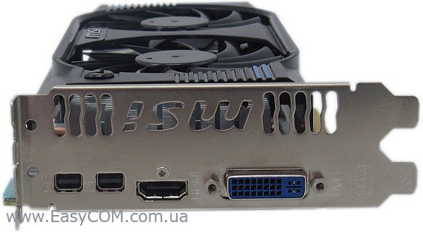

I already have the four monitors. 1 acer 22 inch monitor, 2 dell 19 inch monitors, and 1 lg 32 inch tv. My current graphics card is an MSI 7770 that has 1 DVI, 1 HDMI and 2 Mini DisplayPort adapters that run my setup just fine. If i was to get this card I would have to get an active DisplayPort to DVI adapter but I just wanted to make sure that this card would handle that. I've seen some information that says a graphics card can't run more than two DVI/HDMI connections at a time.

Can you explain exactly in detail how each of your monitors is connected?
Your I/O panel on the 7770 looks like this correct?
Yes that's the card I have. I have the hdmi connection going to my 32 inch TV. One display port going to my 22 inch monitor. And I have two active mini display ports to vga going to two 19 inch monitors.
Like everyone else has mentioned the documentation on it is almost non existent and not helpful. I see the Sapphire card that has the 2 display ports to do it but that's like the only card like that. It just seems weird that most manufactures are going to the 2 DVI 1 HDMI AND 1 Displayport and still claiming it can handle 4 monitors. Unless they're counting on the fact you have to use a displayport hub.
How are you using a DisplayPort to the 22 inch, using a DVI-D Male to DisplayPort adapter?
That means on the Sapphire R9 380 I linked, you'd also be using just 2 legacy connections (HDMI to 32" TV + DisplayPort to DVI cable), not 3 (which means your limitations doesn't seem to apply).

Ya, so the Sapphire R9 380 mini ITX would be connected the same way as your HD7770. What is the reason you are upgrading from the 7770? Did that card die?
Ya i might have to settle for that instead. I just don't see why out of the r9 series that's the only one to have those ports along with an xfx 280x that has the same configuration. I'm just looking to upgrade because this card is starting to struggle on games these days.
You also have an Nvidia card, so the display port limit isn't an issue.
