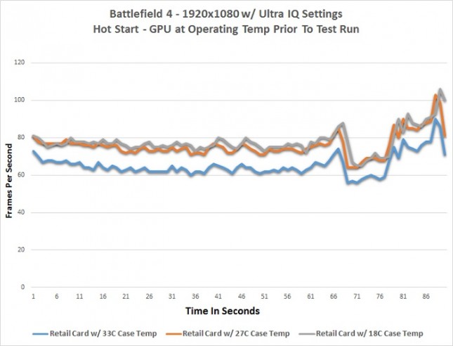

More reviews show that press cards are performing better than the retail cards, but this review is a little more interesting.
http://www.legitreviews.com/amd-radeon-r9-290x-press-sample-versus-retail_129583
Page 3 is where the fun starts. What do you guys think?

I'd have to agree in this case. People are buying cards based on misinformation, the retail cards are throttling significantly more based on data presented by both Tom's and Legitreviews.
The performance drops in those benchmarks at LR are alarming to say the least - the card dips in performance with each run. Runs fine when cold, performance nosedives when hot.

It should be noted that this performance variance is really only significant in quiet mode as that is when the new AMD PowerTune technology is busy trying to keep the card quiet.
