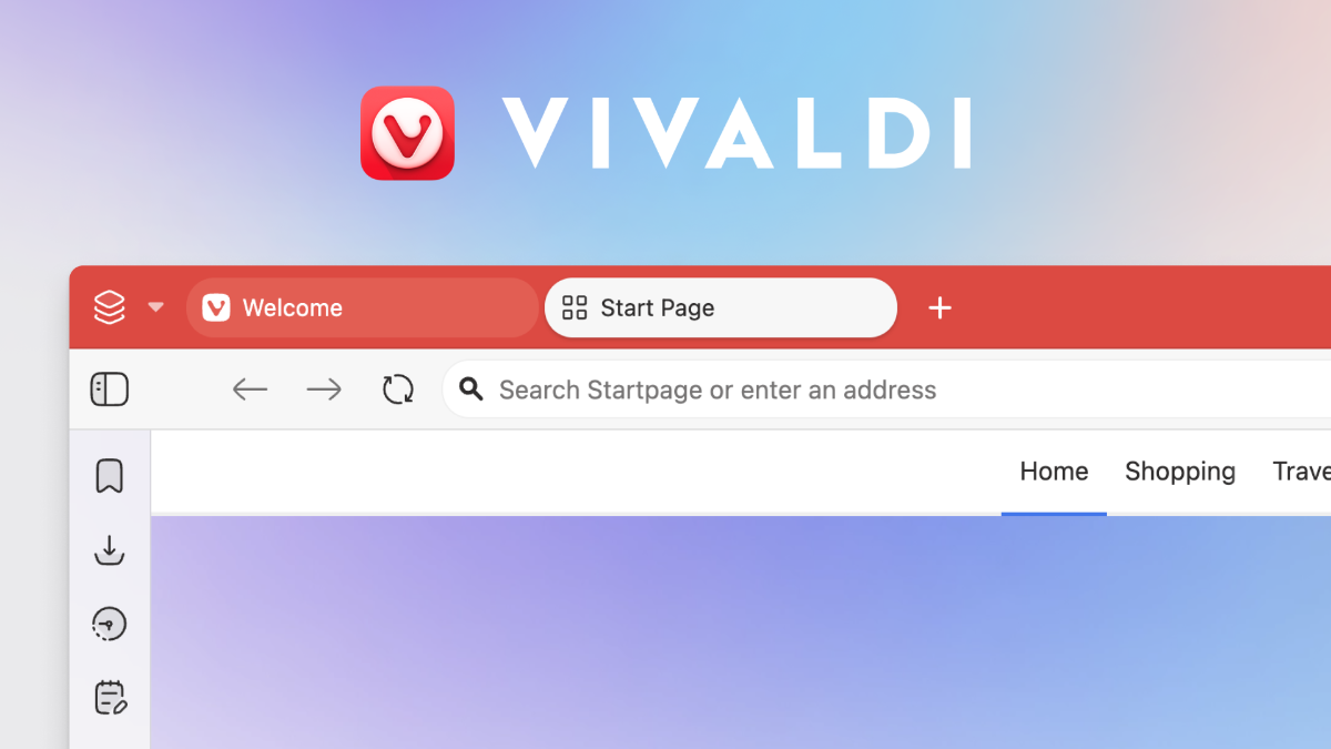

Vivaldi isn't new, but it's pretty cool in many ways. I have it on my notebook, but haven't put it on a mobile yet.
It's just another Chromium clone though, same as Brave and Opera.
In fact, I may try it on mobile as I'm not overly satisfied with Brave, DDG or Adblock's attempts.
Vivaldi isn't new,
I hadn't heard of it before seeing the mention of it on the news feed. Of course chromium based options have existed for quite awhile ( decades ). Chrome though has worked fine for quite awhile and no need to look into other options until this. If it's bypassing DNS though it makes me wonder what else it's leaking in the process.
