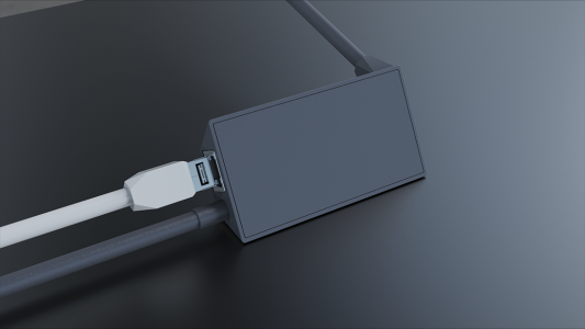

In case you want to stick to a wired connection, what generation Starlink kit did you install? I don't think you need an ethernet adapter for either 1st gen or 3rd gen as they both have built-in ethernet. If it is a 2nd gen dish kit (the square actuated one), there is an optional ethernet adapter for it to convert it to wired ethernet. It is currently discounted in the Starlink store for sale for $17.00.
EDIT: Sorry, you have to be logged in to your account at Starlink to see the above link. The adapter looks like this:

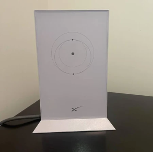

The Gen 2 mesh router stands vertically like this and only has a power port and the satellite cable connector at the bottom of it:

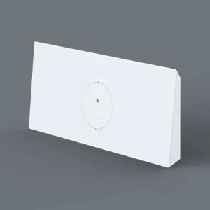

The Gen 3 mesh router stands horizontally like this and has the satellite connector, power port, and two ethernet connectors in the back:

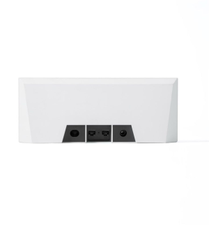

The back of the Gen3 router should look like this:
Port on left is the satellite cable port (it is actually CAT6 POE ethernet cable from what I recall), the two ports in middle are the ethernet ports, and port on right side is where the power brick for the router/dish plugs in.
You should be able to just run a short ethernet patch cable from one of the ethernet ports on the router to the ethernet port on your mother's PC.
