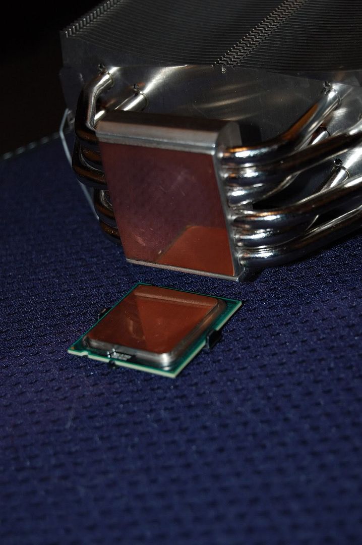

Certain TR U-120-E has some surface issues that makes contact with the IHS. I lapped mine just to make sure I would have an even and flat surface to make contact with the IHS.
Lapped TR U-120-E

thats a lapped true & a lapped C2D IHS. I plan to lap my true & my IHS I've heard a lot of bad stuff about the TRUE's base having ridges, and most people do lap them. You also want to use just the bare minimum spread of thermal compound on the surface of the IHS to where you can see the copper through the thin layer of thermal grease.

oh dude, thats horrid. Ruffles have ridges, but cpu's and heatsinks need mirror finishes. some people have lapped & polished the cpu IHS and the bottom of the TRUE and then ran the combo without even using thermal compound
you will also get a 10-15c drop using two properly mounted flat surfaces with minimal thermal compound compared to using a concave intel IHS, and a ridgid TRUE with a icecream size scoop of AS5 filling in the air pockets.
