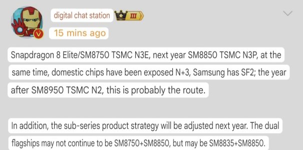

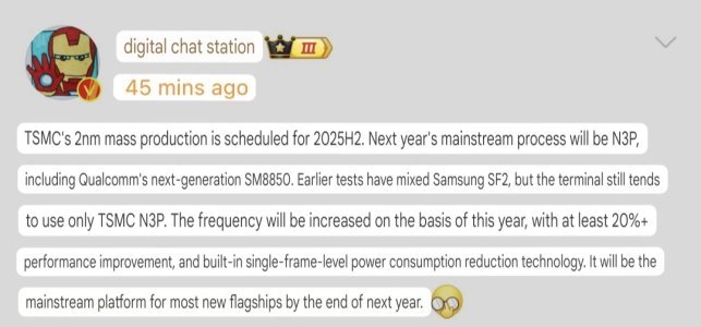

Rumour:
8 Elite G2 tested with TSMC N3P and Samsung SF2, but the mass production version will only use N3P.
