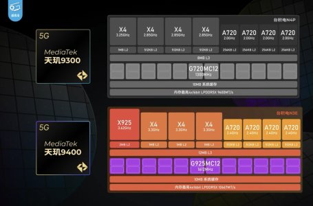

Historically, the Cortex A7xx line has always been deployed as performance cores, but the Dimensity 9300/9400 have demonstrated that they can be used as efficiency cores too (and excellent ones at that!).

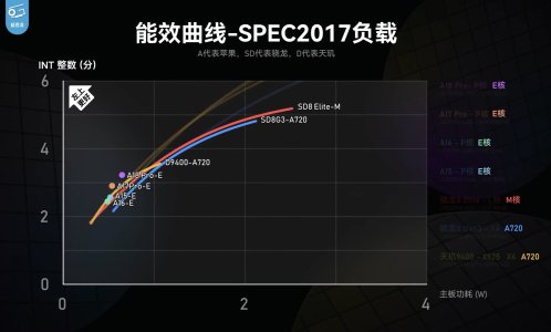

Perf/watt of Phoenix M doesn't seem so great vs A720, which is already a year old core.
Much different performance points, though, one would have to compare power at the same performance or performance at the same power to get an idea.

Qualcomm is just pushing the M core way past its sweetspot, because its whole point is not more power efficiency but merely more MT performance in an area efficient manner.
Apple E core on the other hand, and watching its architecture and area size, there is no way that it's so much slower than Oryon M, it's most likely extremely frequency capped to be very efficient.

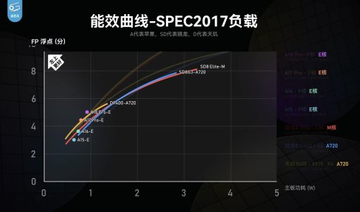

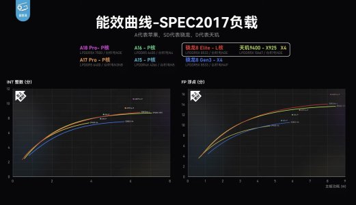

Yup, We have curves from Geekerwan;

My speculation for Oryon-S is that it would be same core as Oryon-M, but clocked significantly lower (~2 GHz) and with less L2 cache.

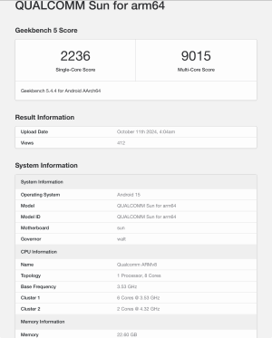

What's the Geekbench 5 Multi Core score of Snapdragon 8 Elite?
Has any reviewer tested it?
Geekerwan didn't.

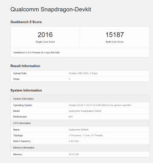

Here is the only score the browser finds:
That's the 80W SDXE X1E-00-1DE? I think FlameTail was looking for the phone chips.
But if anyone is curious here that is compared to a 5L ITX Zen 4 PC at 100W PPT with DDR5-5200 memory

Geekbench 5Geekbench 6
A18 Pro2450
7000
3500
9000
8 Elite2250
9000
3200
10500
8 Elite is ~30% faster in Geekbench 5 Multi Core, and ~15% faster in Geekbench 6 Multi Core.
Curiously, A18 Pro also has a ~10% lead in Geekbench 5 Single Core.
