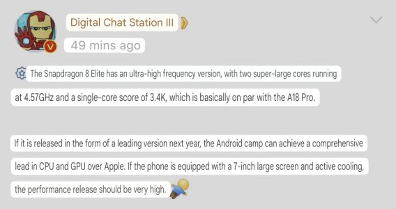

Rumour [DCS];
4.57 GHz.
That's bonkers. It's 0.25 GHz (or +5%) higher than the standard version of 8 Elite (4.32 GHz).
This one would be able to solidly claim the GB6 single-core crown from Apple A18 Pro in Geekbench 6.2 (no SME).
Also 4.57 GHz is just 0.43 GHz away from the 5 GHz mark. Even if the standard version of 8 Elite G2 is not able to hit 5 GHz, I think the high-clock version of 8 Elite G2 will.

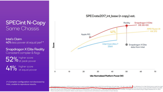

On the other hand if Andrei wanted to do accurate uarch vs uarch comparisons he should have enabled AVX for x64 when doing comparisons on Qualcomm slides as the AVX units belong to the core the same Neon units do (I guess he is somewhat involved with those if the rumours are accurate). But yea, that is a digression;)
He replies;
The LNL binaries were fully AVX2 and what not enabled, the attendees at summit had full access to the complete build config and see it first-hand
MS_AT
Jul 15, 2024
923
1,847
He replies;
That well might be but then they should improve their messaging as
only lists LLVM (clang) 17.0.6 with -O3 and -flto. Link time optimizations are indifferent to the point we are discussing so it leaves us with O3 only.
https://godbolt.org/z/rnPvW8jnc this is very trivial loop so to ensure compiler will auto vectorize it, you can see that -O3 option is doing vectorization using only xmm registers and does not use fma operations compared to the assembly for the -O3 -mavx512f on the right that is using zmm registers (512b width, avx512 only) and fma operations. [Yes it's using clang 17.0.1 instead of 17.0.6 but this behaviour won't change]
In other words based on the information they made public, one can assume "AVX2 and what not" was not enabled. So for the future they could simply put the link to the full compiler options so they would not bloat the slide if they were afraid about that and nobody would say then these were not enabled.

Rumour [DCS];
4.57 GHz.
To reach the A18 Pro level, you must overclock the Oryon core as much as possible and provide active cooling🤣. This is reminiscent of Geekerwan's recent Ryzen 9900X review, where the chip was overclocked under nitrogen to beat M4 in SPEC tests. That's ridiculous.
Tbh, the way he phrased it, active cooling is optional.
If you look at the ST power curves, the 4.32 GHz 8 Elite actually consumes less power than the Dimensity 9400. We know that Dimensity 9400 phones don't need active cooling.
A 5% overclock would increase the power by 10-20%
But it could even be less than that if they are using chip binning. Bin the high quality chips and push them to 4.57 GHz, while the rest hum along at 4.32 GHz.
mvprod123
Jun 22, 2024
530
573
This is still called creating special conditions.
I agree.
OTOH the difference should not be massive. I don't expect a significant amount of vectorized code in SPECint 2017 except for x264.
Reactions: Hitman928 and MS_AT
I think power would be increased more than that, look at the shape of the curve, for example in the fp test, going from 6 to 8W (33% increase) nets you 5%, maybe 6%? more performance. It's only getting worse if you overclock 5%.
Of course, with binning it's another story, but as it stands, a 5% overclock with the same SoC would be very costly in power consumption.

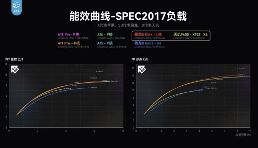

Revisiting this slide;
The efficiency uplift from Oryon (X Elite) to Oryon-L (8 Elite) is truly wild.
~17W to ~8W.
A 2x efficiency gain in 1 year/1 generation!
Yeah I know it's a Qualcomm slide, but testing by Geekerwan does corroborate those numbers;
X Elite8 Elite
SPEC2017 INT15W6.5W
SPEC2017 FP20W8W
Reactions: Racan
