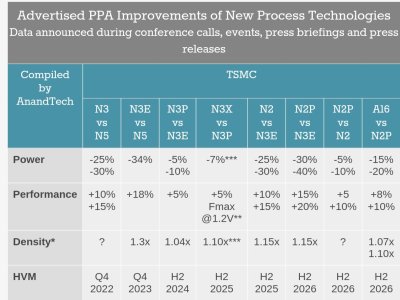

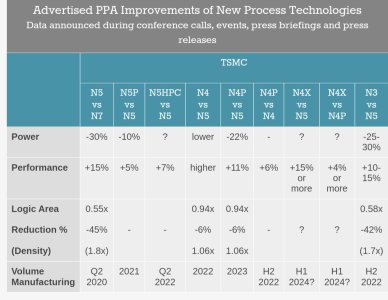

Do note that while X Elite is on N4, 8 Gen 4 is N3E.
X Elite - N4P. The difference between N4P and N3E is not significant.
FlameTail
Dec 15, 2021
4,384
2,762
Versus N5,
N4P
-22% power
+11% performance
N3E
-34% power
+18% performance
I wouldn't say that's a negligible difference, in this day and age where Moore's Law is dead.
