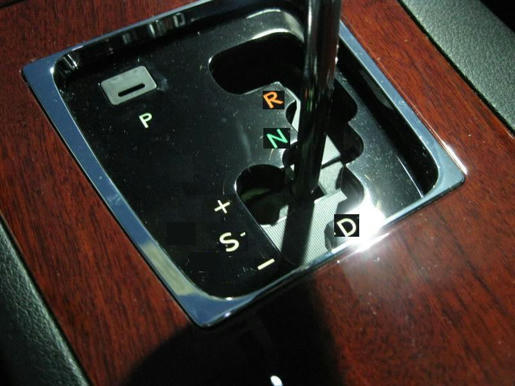

http://i3.photobucket.com/albu...917-1911M/IMG_1981.jpg
I finally know why the guy didn't shift into neutral.
Poor shifter layout and markings.
A lot of people would never find neutral if they had to in a hurry.
Holy crap. Is this post for real?
YOU PUSH THE SHIFTER FORWARD. THAT'S IT. BAM. NEUTRAL. You don't need to move it around at all, you just push forward and it's there.
In my Accord (shift button rather than staggered gate), you don't even need to push the button to get neutral. There's no lockout or anything. You just push forward and it's there. How could they possibly make it any simpler other than installing lawnmower-style kill-switch handles that you have to hold the entire time you drive?
Did you even read the thread on rimfire central, where the picture was lifted from? The author states that moving the shifter to the neutral gate on the left at full throttle does not actually shift the transmission into neutral. The ECU for whatever reason locks out neutral under WOT. The only way to get into neutral is to move the shifter into the center gate and hold it in the forward position.
Intuitively you'd do exactly as you suggest, move the gear selector forward to the gate marked N on the left, at an idle I do believe this would work, even at low RPM it may work but at WOT apparently it doesn't, instead the driver has to find a position in the gear selector that is normally ignored and not obviously marked on the center console. In a moment of panic with 100 MPH quickly approaching it may not be so simple to find neutral the way the gear selector is marked combined with the fact that the ECU overrides the manual gear selection under certain conditions. I've never driven a vehicle when the throttle gets stuck wide open, sitting at my desk it's easy to say I'd shift into neutral and apply the brakes, but being drunk on adrenaline in a real world scenario I can't say I'd do much better than stuffing it into the guardrail.
I see that you might not have found Neutral in the Lexus either if it was your first drive.
In the picture the shifter is in Neutral. Drive is straight back from Neutral.
A person unfamiliar with the car will almost certainly put the shifter all the way over to the left, in the "Shift it yourself" S gate, for Drive. Since they won't be shifting it themselves, they will never know that it isn't actually in Drive, but in Sport mode.
Looking at the shifter, and not realizing you aren't in Drive, it looks like you should push forward for Neutral. There's a green N right there. Well, that won't get you Neutral. A forward push only gets you an upshift. Neutral is right and up from Sport mode.
The right gate is R and N
The middle gate is N and D
The left gate is S
With a little practice, you'd get the hang of it. Without practice and in an emergency, I can easily see someone claiming it would not go into Neutral. I can easily see why the driver in question probably didn't realize where Neutral was.
The N and R labels should be moved over to the gates they are actually in, imo.
I'll bet a lot of folks are driving around in S instead of D.
What are you talking about. Standard layout - push shifter up from D to N, pull shifter from N to D. It's the same thing, the only difference is notched shift pattern.
Try to put yourself in the shoes of a person who just got the car and is unfamiliar with the shifter.
Don't you think they might put it in S and not realize it's not actually Drive?
Once they have made that error, it's logical to think that Neutral is forward.
What if he'd never driven a slapstick before and thought that the shifter was returning to drive and refusing to stay in Neutral?
It's an easy mistake, imo.
Of course, I don't really know how familiar the guy was with that Toyota pattern. For all I know, he had driven a car with one before, and there's still no explanation of why he didn't use Neutral.
My crudely relabeled shifter gates. 😀
http://www.mediafire.com/imgbn...d1fd8c17c79eee594g.jpg
If neutral doesn't work, toss it in Reverse. Park. Turn off the ignition, hold the start button. It's common sense. If you got enough time to call 911, you've got enough time to problem solve a device you've used a million times before.
Besides the point, it says S-D on the shifter. That alone should give you the idea that there are 2 positions when the shifter goes across... plus it LIGHTS UP THE SELECTED POSITION.
It's that or you can have the idiot's solution of ziptied mats to the seat. Poetic justice IMO.
Come to think of it, the guy dropped his own car at the Lexus dealer for service, which suggests he should have been familiar with the shifter.
I wonder if he always drove around in S, blissfully unaware that he was not in D?
If you are driving in S you would know, because the display on the dash tells you that, and also it tells you what gear you are in. Also the gears would never shift if you are in S and that would be a problem.
Gear information is not displayed if you are in D.

Thinking about it, for me, not going into Neutral wouldn't make me panic. I'd just move on to the next attempted solution.
If you just put the shifter in S and don't do anything, the trans won't shift? It will stay in first gear, you mean?
If so, that would seem to put the blame on the car again because it would eliminate any confusion on the part of the driver.
"The initial shift range in S mode is automatically set to 5 or 4 according to
vehicle speed."
I think that means it will shift by itself if you put it in S and don't do anything else.
It's essentially in Drive, but 6th gear won't be used.
At least, that's the way I read the 250/350 manual.
The way you made it sound was that people drive daily all the time not knowing they are in S which wouldn't work.
But yea if they shifted into S while they were driving it would do as you state
vehicle speed."
The Camrys I've been renting have this same shift pattern and (I believe) the same 6-speed automatic (Hertz rents the Camry SE variants with the 6-speed rather than the 5-speed LE models).
The "S" mode allows a driver to select the highest gear used by the transmission, and while the transmission will no up-shift (it will let you bounce off the rev-limiter forever if you select 1st gear, don't tell Hertz that I tested this), however if you select 4th or 5th from a stop the transmission will still start out in 1st and shift up through the gears normally.
Holding the slap-shifter forward in "S" mode will select S-6 mode without needing to progress through the intermediate modes (e.g. if you're in S-2 and push the stick forward and hold it, the transmission will select S-6 rather than S-3 as it would if you just pushed it forward and immediately released it).
The "S" mode is mainly useful for downshifting on long hills or to prevent hunting (for some reason I've noticed that the transmission hunts between 3rd and 4th at a steady 25 mph so I'll use S-3 to lock out everything above 3rd and prevent hunting in towns). It also does slightly change the shift mapping to make the shifts a bit firmer and to respond with a downshift more readily when you give the car more throttle.
"S" mode also will not allow a manual downshift at certain speeds, even if the downshift would not cause the engine to operate at redline. For example, 2nd gear does not redline until about 40 mph, but if you try to downshift into S-2 at 30 mph, the transmission will not allow it.
It took some getting used to.

My car does the same thing - put it in tip mode and it will not upshift (will downshift however). The fact the S gate has up and down (+ / -) gates would make me thing it works the same way.
