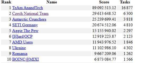

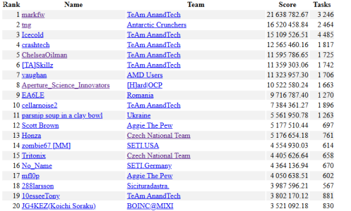

unoffical day 2 but 2 am. and its only top 10 teams and top 20 useds, as more won't really fit the way I do it. (pictures)
