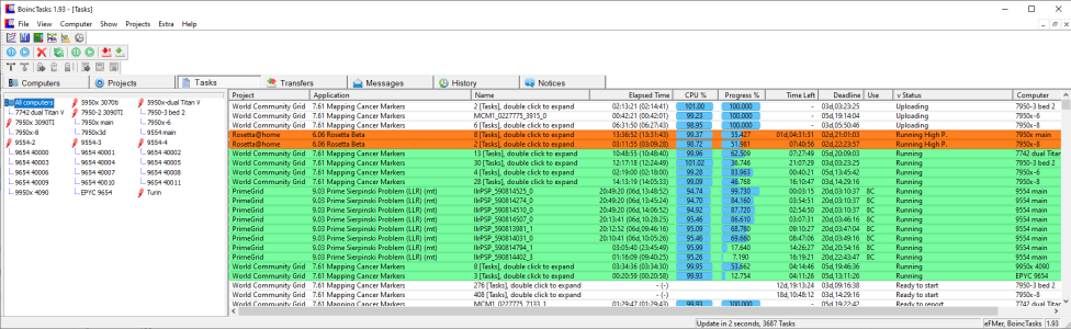

OK, I only have one 9554 running, but it did one unit in 17 hours, but the next 8 have been running for 20 hours and not done yet. These are LONG running units ! almost 24 hours it looks like ! (8C config) Should I try 16 C tasks ? Only a little over 2 days to figure this out.

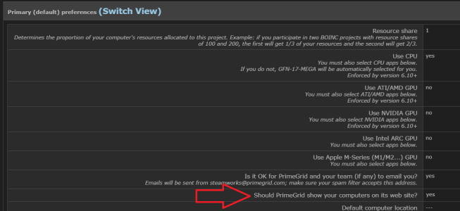

well, crap. Somebody showed me how to hide them, now I can't find is again to unhide !
Help !
@emoga Thanks ! done ( I think) let me know !
Edit : Not the logical place to put it when you have multiple profiles, you don't expect one to be different from all the rest.

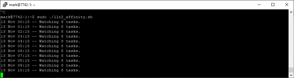

So I turned it on, and it will stay on for the competition. But I will have no new tasks set shortly to be ready for the competition. So igmore all my previous run times, and than a lot @StefanR5R , @emoga
Well, stupid me, glad it's back on, now 14.5 hours instead of 27. no other changes.

Edit: actually its due in the next hour.Well, the 7742 with 8C units will take almost 2 days (about) Once the Turin is up, and it has finished one set of tasks, I will shut it off, so I know what you mean about slow computers. And yeas that is with pinning
PrimeGrid 9.03 Prime Sierpinski Problem (LLR) (mt) llrPSP_590816579_0 11:54:00 (03d,20:02:01) 96.67 21.710 01d,18:52:22 20d,12:05:49 8C Running 7742 dual Titan V
