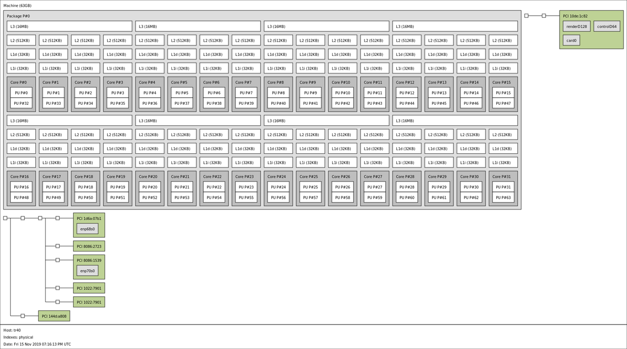

Right, I can try this with taskset added to my script.
(Note to self: lscpu shows that logical CPUs 0-31,64-95 belong to socket 0, logical CPUs 32-63,96-127 belong to socket 1. lscpu -e indicates that logical CPUs 0-3,64-67 belong to the first CCX, 4-7,68-71 to the second, and so on.)

I was having a difficult time imagining that numbering description, but then stumbled upon this diagram of a Threadripper 3970X, which helped it make sense, even though it "only" has half the cores:
Reactions: Ken g6
