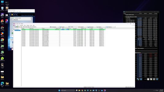

I am only getting one task per machine at a time. Is that normal?
If it's keeping all your real cores busy it's not abnormal. It may not be completely optimal in every case, but it's close.

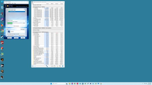

Reason for asking is my least machine with the 7800X3D is sporting two tasks. The rest of the big dog machines are only downloading and running one task at a time. Maybe the reason my scoring total is so meager at this stage?
The 9950X is about to upload one in 20 minutes.

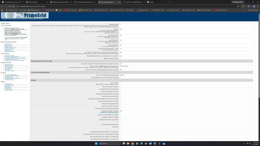

Check to make sure you're not limiting 1 or 2 tasks at a time at the Primegrid preferences.

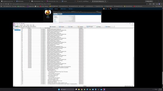

What does the message log say for the hosts not getting more tasks? It will usually tell you why it's not getting more.
Do I need to install BOINCTasks on each machine in order for them to be discovered? Where is this message log located? I have no clue as to how to determine how many cores the tasks are.

Just noticed your boinctasks screenshot. Each task is actually using 32 threads on that computer. That's why you're only running one.

Look at the BT tabs. One says messages.

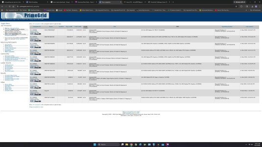

If you go under your computer list on the Primegrid website you should be able to see what 'venue' each machine is in. It sounds like you have the ones that are running 32 thread tasks set to a different venue than the one in the screenshot above.

So, what number do I need to input in the threads per task? I have tried unlimited, 4 and many in between in the past with no effect.
If you go under your computer list ("Computers on this account") on the Primegrid website you should be able to see what 'venue' each machine is in. It sounds like you have the ones that are running 32 thread tasks set to a different venue than the one in the screenshot above. It's the second column over. You would want to have one venue that is set to 8 threads per task and have any 8 or 16 core CPU machines in that venue. And another venue that's set to 6 threads per task for any of your 12 core CPU's and have those machines in that venue. The venue names are default, home, school and a bunch of planet names. If you scroll down on the preferences page you screenshotted above there should be the other venue settings.
As mentioned by Icecold. There is not a one size fits all.
These tasks are using around 33MB of L3 (or more) So you need to find out how much L3 cache your CPUs have and that'll be able to tell you how many tasks you can run at once. Keep in mind the CCD/CCX layout of AMD CPUs as mentioned above.
Once you figure out how many tasks you can run on a single CPU. You simply divide the number of physical cores evenly between them.
I think there's actually a bug in BOINC 8.2.8 where it doesn't respect the thread count setting on BOINC projects. Maybe somebody here can chime in with more info, I've never ran that version but I've heard of it having issues where it won't accept thread count changes from the web preferences. You might actually not have anything set wrong it might just be the BOINC version, I didn't think of it until I saw that version on your screenshot.
