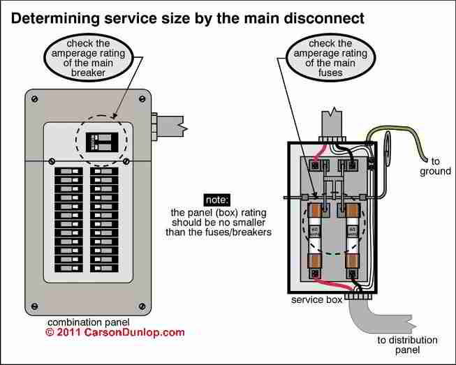

Look at the main breakers to determine amperage. It's not a big deal to add a sub for more breakers.
If the mains are undersized you need to contact your utility company. They'll have a list of requirements for upgrading your service.
