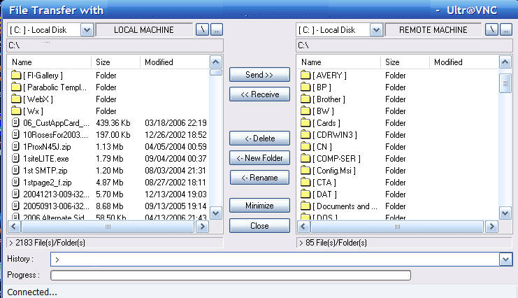

Or you can use UltraVNC. You can choose a port and once you are connected shares does not matter.
UltraVNC does Remote control, and it also has a File transfer Module that gives access to all the Drives on the remote computers as is.
Looks like this, http://www.ezlan.net/example/vnc_file.jpg
Use the native 128 AES encrption module and it is just as Safe as VPN, SSH, or any other protected Interent traffic.
If you have few computers you get into any one that you want to by just assigning each one VNC with its own unique port.
