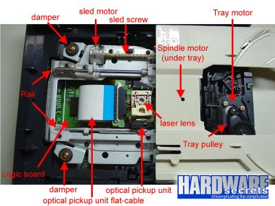

No need to buy some commercial 'cleaner' product. You can open the case/chassis and use a soft Q-tip slightly dampened with rubbing/isopropyl alcohol to swirl around clean the optical pickup/lenses they are usually reachable and easy to spot. Do it a few times (using a new q-tip each time). Then let air dry. Maybe give it a targeted blast of air to blow away any dust or fibers.

I'll try cleaning lens like you say? Is there just one lens to clean or are there multiple lenses in blu-ray burners? They have to rip/burn BR/DVD/CD.

I suppose I can remove the enclosure and look for the lens. Could operate it and see where a disk loads and go from there if it's not apparent.
