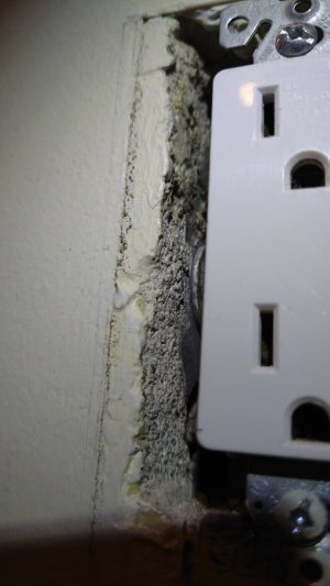

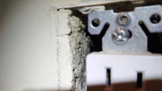

Just wanted to put these photos here to show you guys what kind of wall I'm talking about. This is what I'm drilling into and trying to mount on. It's not that super polished dense concrete they use frequently in those exposed concrete condos and in modern parking lots. But it's masonry for sure, cold to the touch, etc.

Part of the confusion is you're talking about a 35lb mirror but then show us an outlet? Does not compute.

I thought it was pretty clear that I've removed the plates from an outlet "to show you guys what kind of wall I'm talking about". Sorry, thought it was self evident. I thought it might be interesting to see what kind of wall I'm working with.

It looks like 3 coat cement plaster. Hollow wall anchors are rated by weight on the package, so that would be your guide. Hole diameter is important with hollow wall anchors which will be advised on the package. Butterfly anchors open after inserted into the hollow wall behind the plaster and are tightened with a machine screw so they cant pull out without removing the screw. Butterfly anchors require a fairly large hole in order to get the butterfly through. I wouldnt use wire in the hole since the wall is only 3/4 in thick.

Sorry, was sleepy and could not see the finer details if your pics, that it's hollow, not a full thickness concrete wall. I agree with jmagg to use butterfly anchors.

But to the issue at hand... I'm no DIY expert but this ain't plaster, and it isn't hollow. I got 5 inches in with the drill bit before I hit something that felt cavernous. I've used a lot of hollow wall anchors on plaster and even cement plaster in many apartments, but a hollow wall anchor isn't going to be of any use here. I guess the photo doesn't show it well but the black space is shadow behind the outlet, not empty space. And it goes all the way inside the hole for the outlet like it was excavated out of rock.
