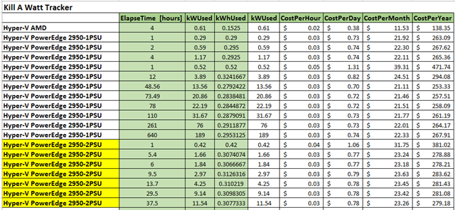

SunnyD; you make a good case for stepping up sooner than later. What is a good hardware platform to build on? Used servers with tons of memory are going dirt cheap.
Speaking of comfort zone: wtf am I getting myself into...? :)
edit: I need to know what to buy...
I built myself a dual LGA1366 machine with two L5639's when they were the hot thing on eBay. I managed to snag a Tyan S7012 that also game from ebay on the cheap. CPU's were about $70 each and I got a steal on the motherboard for around $125. The pricey part was the memory, but I ended up with 48GB of ECC DDR3 for decent prices.
edit again: Is this what I'm looking for? I checked that the processor is 64 bit, and it's only $150...
Dell PowerEdge 2950 server
CPU: 2x 5355 quad core Intel Xeon processors : 8 cores
RAM: 32Gb DDR2
Storage: 2x 73 GB SAS 3.5" HDDs; the backplane is SATA compatible
Perc5/i RAID
Network: 2x 1Gbps NICs
DRAC remote control card
Power: 2x PSU
As others mentioned, a 2950 is really long in the tooth at this point. It will be old, hot and loud. Yes, it will work, but you'd be better served by an R310 if you can't step up to an R610/710. Yes, you'll spend a little more up front, but it's actually worth it. The suggestions for the HP DL380's are also very good.
If you're patient enough with eBay, you should be able to find a steal on one of the older servers there, and they should out of the box be certified for either Hyper-V or ESXi.
