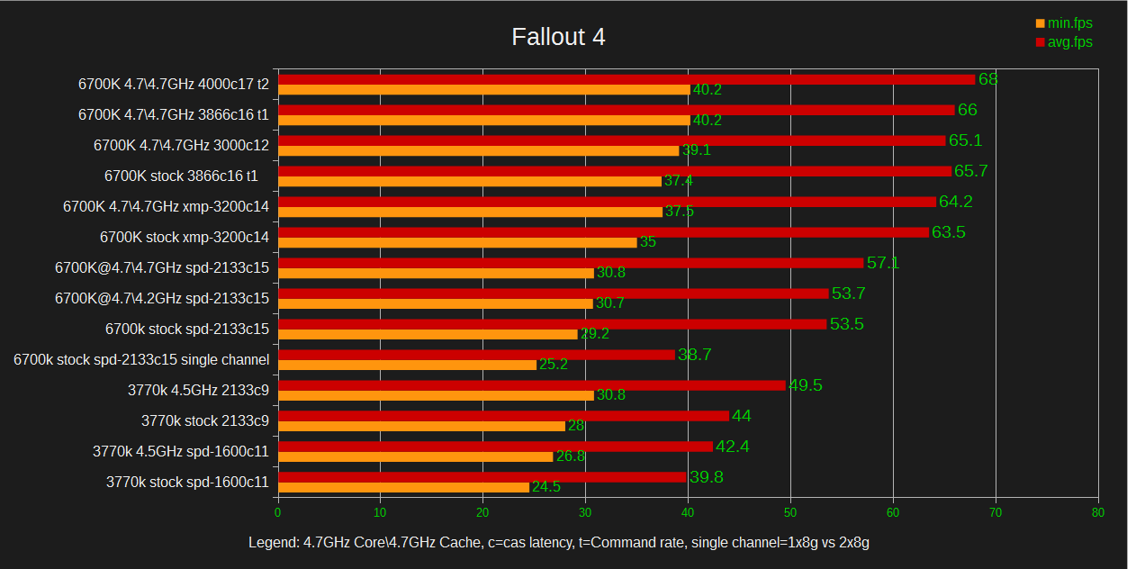

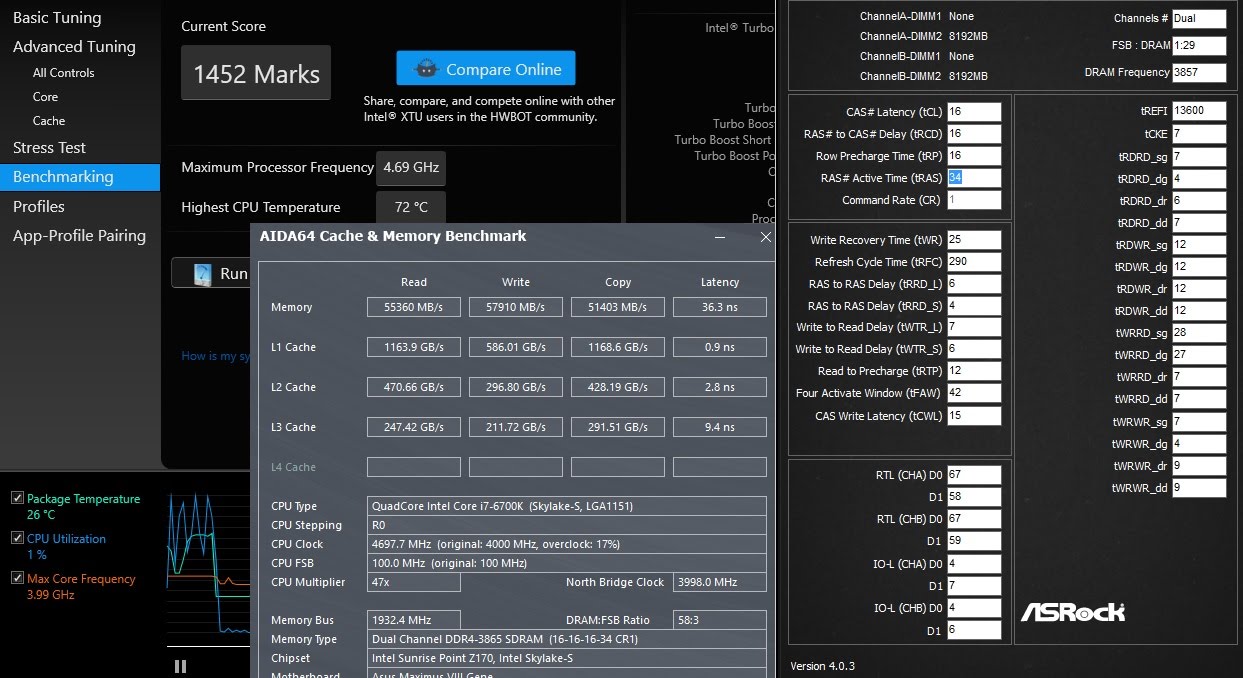

Overclocking ram on my systems makes more difference than overclocking the cpu in most games and putting both together make for a very nice increase in cpu performance
Is there a point where it becomes bad value? sure but it does help and it is possible to get high speed ram that's good value (much better value for gaming than a i7 over a i5)
The kits below were samsung oem ddr3 1600c11 and g.skill 3200c14 which were purchased due to there overclocking capability and didn't cost that much more than slow kits of ram that couldn't oc
As for going over 16G I agree its a complete waste if all you do is game although there is some limited tests that suggests there may be a benefit from running dual rank ram which would mean running 32g with most of today's chips and its unclear if the gains from dual rank out way the loss of frequency

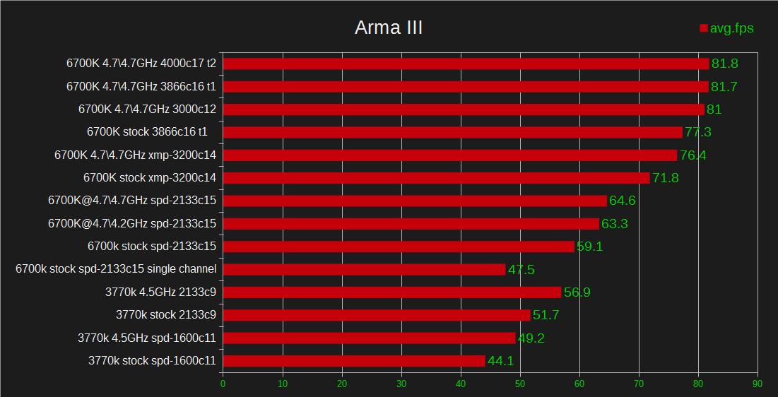

For arma 3 i used a stratis time demo average fps are nice and consistent but the minimum were very random so i left them out
Average fps in fallout 4 are not perfectly accurate im afraid due to it being a short run through the park with low fps at the start and high fps at the end if i was a second out starting\stopping the test it could throw the results a bit but the minimum seem very consistent

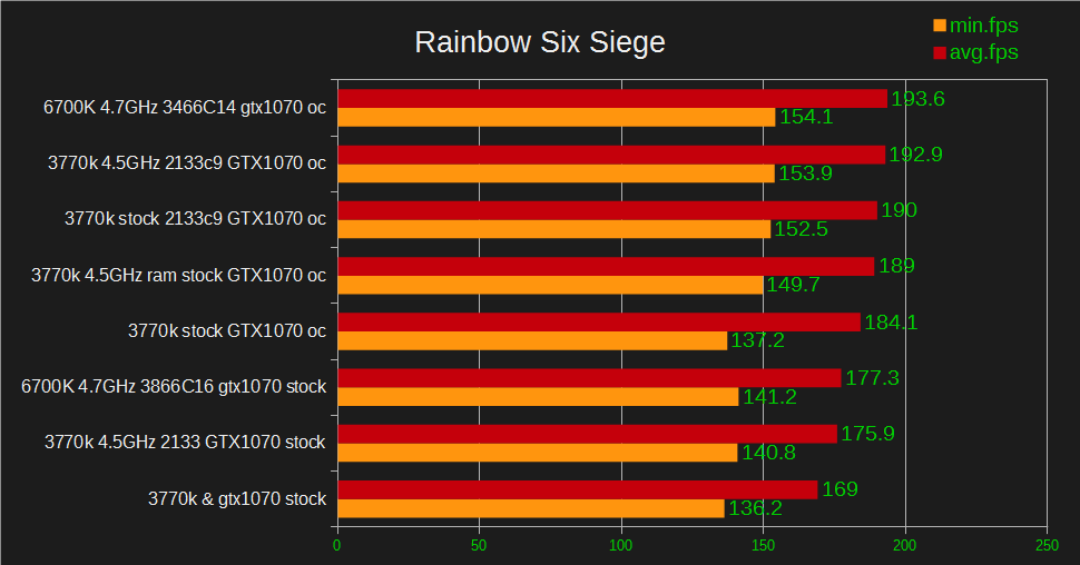

R6 your typical gpu bottlnecked game most ram reviews use here you can see the 3770k at stock with the gtx1070 oc is faster than the 6700k oc with stock gtx1070
R6 had the gpu pegged at 100% load while arma stayed well under being cpu bottlnecked
There is minimal improvement but the ram oc still makes a bigger difference than the cpu oc

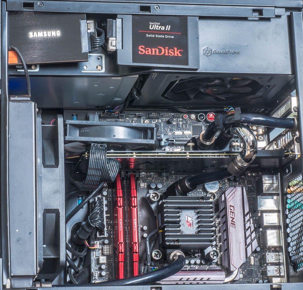

Test System
3770k -- 6700k
Asus Maximus V Gene Z77-- Asus Maximus VIII Gene Z170
Samsung DDR3-1600c11 2x4GB 1.35v dual sided -- G.Skill DDR4-3200c14 2x8GB single sided
EVGA GTX1070 SC (OC=+75 core +750 mem +112 powertune use on all tests)
64g Samsung 830, 1tb Sandisk ultra II, 3tb WD green
Seasonic XP 1050 < tad overkill for the current system which has topped out at 306w from the wall
Silverstone TJ08-EW
Swiftech Apogee drive II
200mm Phobya rad + Silverstone Air Penetrator AP181
EK VGA Supreme HF
Win10

I also tested with aida64 and showed all sub timings used at each setting if you want a look
http://www.overclock.net/forum/1805...0c11-2133c9-ddr4-2133c15-3000c12-4000c17.html
